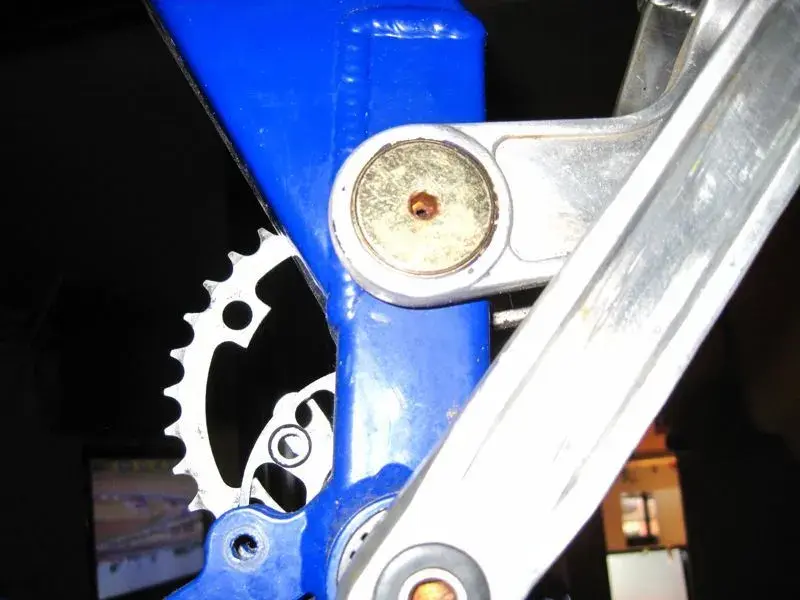

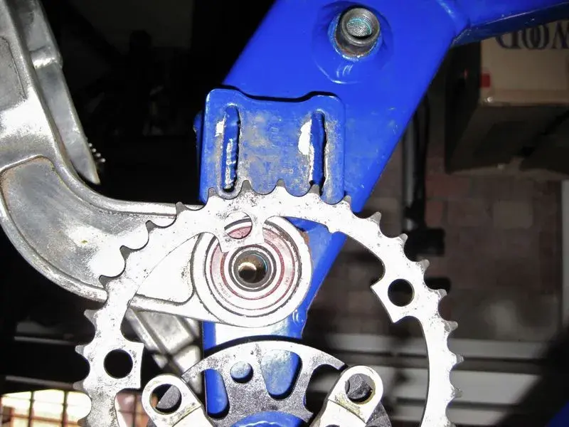

Curious if anyone here has ever taken the rear swing arm off a Giant ATX Team or ATX-One before ?
I bought one a while ago and the chainstays are cracked quite bad, one just popped up on ebay and I bought it after looking at it first and its rear end being fine.
Ive managed to get most of it off except the part I need (typical) the drive side pilot cover and bolt came out fine, but the non drive side just turns and you can see main pivot/axel spinning too. I can kinda see a the smallest torxkey hole up there also but thats just part of the cover bolt.
I cant find anything on the net and I really need this to come out/off, or ill just have to cut the frame or pivot in half to be able to get to it.
any help would be great

if I remember correct
the pivot ( the metal tube in the middle of the bearing of the 1st pic)
has to be pressed out find a socket the same diameter as the tube an try to knock the pivot out using the socket an a hammer it probably wont move as its a very tight fit in there
if it doesn't move take it to a garage that that has a press like this

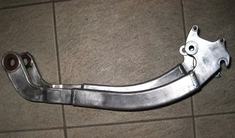

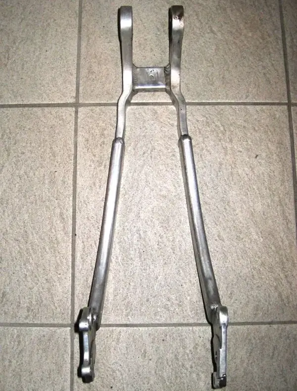

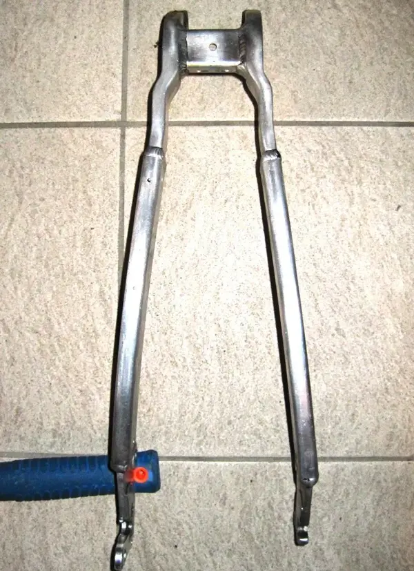

After fighting with this for almost a day and the help of people on this forum and a few others, I managed to get the rear chainstays off.
