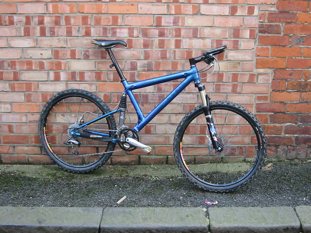

I had the Klein Palomino version. It was good, but I prefer the more active feel of my Yeti. The Klein also sting bugged under heavy braking. A mate has an ML7 & ML8 and he loves them both.
Klein Palomino by ritcheyp20, on Flickr
PostPosted: Fri Mar 29, 2013 7:07 pm
BANNED USER
BANNED USER
Joined: Fri Oct 26, 2012 5:15 pm
Posts: 1075
I can buy EXACTLY the same one for 250 euros, Has a worn drivetrain but it looks cool to me.
