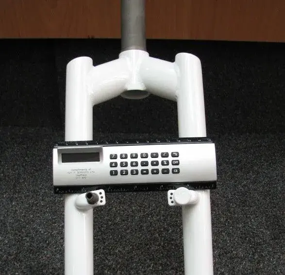

Just bought these over here:
viewtopic.php?f=39&t=245235
Would you be bothered by wonky brake bosses and try to return them (to Planet X, which is about 3 miles from where I live) or just bung brakes on them and compensate by adjusting the pads?

Send em back. They'll always bug you now........

I've always had good experiences with Planet X. If you take your fork back then I think they will refund you or offer you some money back. The last time I went in they were selling a batch of forks with wonky bosses at a big discount. It's possible yours is one of those that slipped through into normal stock.

I visited PlanetX today. The shop staff and mechanics both reckon the wonky bosses are fine - they're parallel so shouldn't cause any problems. Fair enough. I'll cope.
