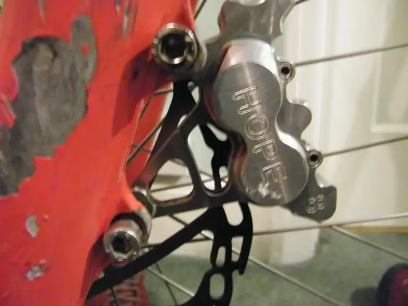

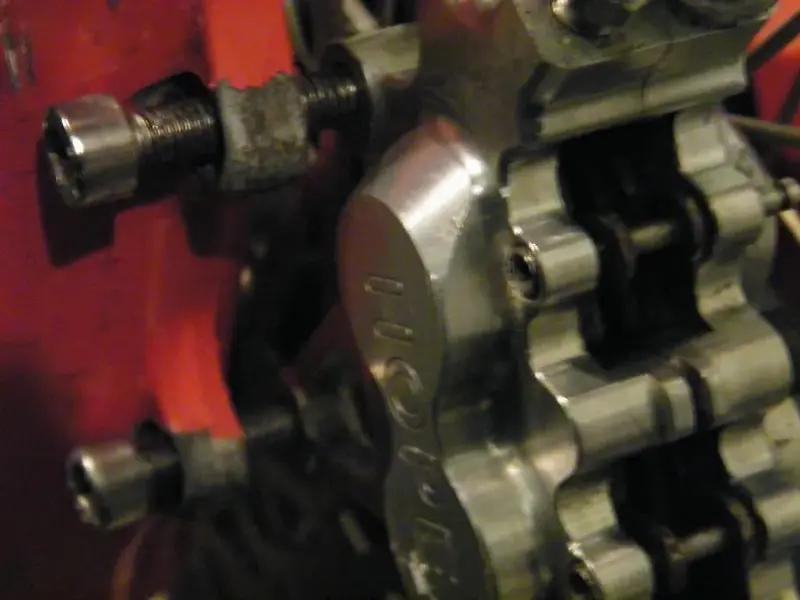

Could it be the caliper then?
Diametre wise i think 225mm would be about spot as the caliper is missing about 10mm of the depth of the rotor
I need some pretty serious spacers aswell :shock:

You have the wrong caliper son
Boxxer is a #6 only - always has been always will be
#8 was a 185 rear or 205 rear with +20mm mount

Ah i see :D
Just to add No. 8 caliper also fits 203 rotor on the front for Pace dual crown forks :D
Anybody got a No.6 front caliper spare? :lol:

Maybe it does but the M4's were designed to with 165, 185 and 205 so you may find it grooves the brake pads a bit running 2mm undersized disks..
