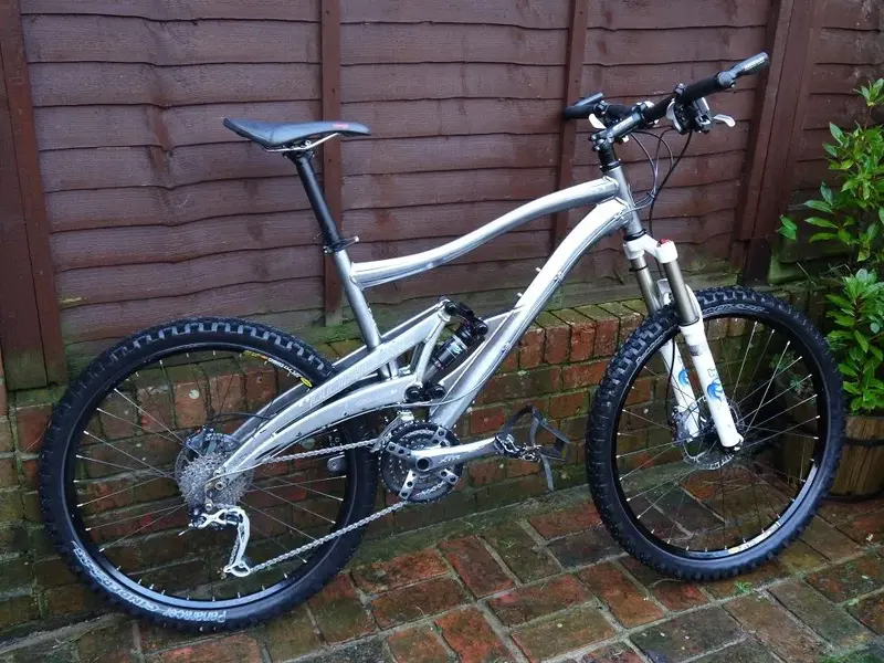

If its any help...I ride a "large" 2008 Marin full suss. In inches from the centre BB to top of seat tube about 19". I am just shy of 6ft 4 and a long in the body rather than the legs! I have the seat up a fair way and a 110mm stem and its fits good...pic below of how it is set up for me:
Wook
