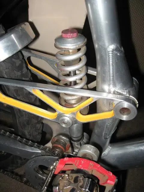

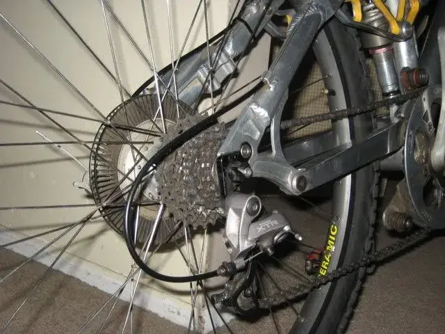

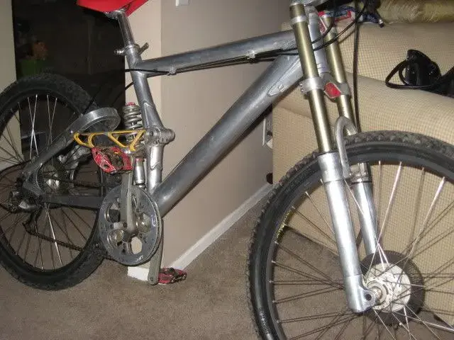

A chap in the states came accross this for $300. After it arrived it was clear it had been stolen at some point...All the pant had been stripped and every sticker removed. The brakes were like something he'd never seen before either..
After doing some investigating it turned out to be an American team GT riders bike that had been stolen. The brakes were prototype cable drum brakes from Shimano (which cost a cool $10,000 a set to produce and never made it to full production)
As you can see the frame doesn't have the curved seat tube like the finished Alu Lobo. The reason they ended up 'curving' the seat tube is that they couldn't get the shock far enough forward to not rub the tyre when at the end of its travel (a problem also found on the carbon version).
The boxxers are also pre-production versions with the bolt on brace.
The back end features box section chain-stays...the ones found on the carbon lobo (very similar to LTS's) were found to be prone to snaping because of the stress of the low down shock (compared to the LTS). This box section found its way on to the finished Alu Lobo. The one piece plates that connect the trunion to the frame and back end were also upgraded to much 'beefier' 2 piece versions. This was to make trunion adjustment much easier as you didn't have to take apart so much of the back end.
The chap who bought this contacted GT about the bike. GT very kindly gave him a brand new bike (some 10 years after the Lobo was made!) so that this could go into their museum at GT HQ.

Those Shimano brakes are prototypes of the Rollerbrakes. They definitely did go in production and almost half of the new citybikes sold today in the Netherlands and Denmark are fitted with these Rollerbrakes.
They are great because they are almost maintenance free and they don't use brakepads (so never have to replace pads), instead it uses steel on steel rollers that set oblique when braking. They last pretty long.
Why they didn't work for DH? Well steel on steel braking; lots of heat and with the heat they start fading, even those big cooling fans mounted on the GT couldn't prevent fading. Plus they are relatively heavy.
So that's why they are mostly used in the flat countries :wink:
That's really interesting! I got all that info off the post I found. I thought I remember seeing team Animal testing some as well in 98-99ish..
You did indeed, back in the day I was fortunate enough to ride on a regular basis with the Animal team, some of whom I'm still good friends with today. At that point in time they had full factory Shimano backing and the roller brakes which evolved into the Nexus range were temporarily fitted on Robin Kitchins Orange Mr O amongst other bikes. From memory they were (as already mentioned above) rather prone to brake fade so testing didn't take too long :wink:
