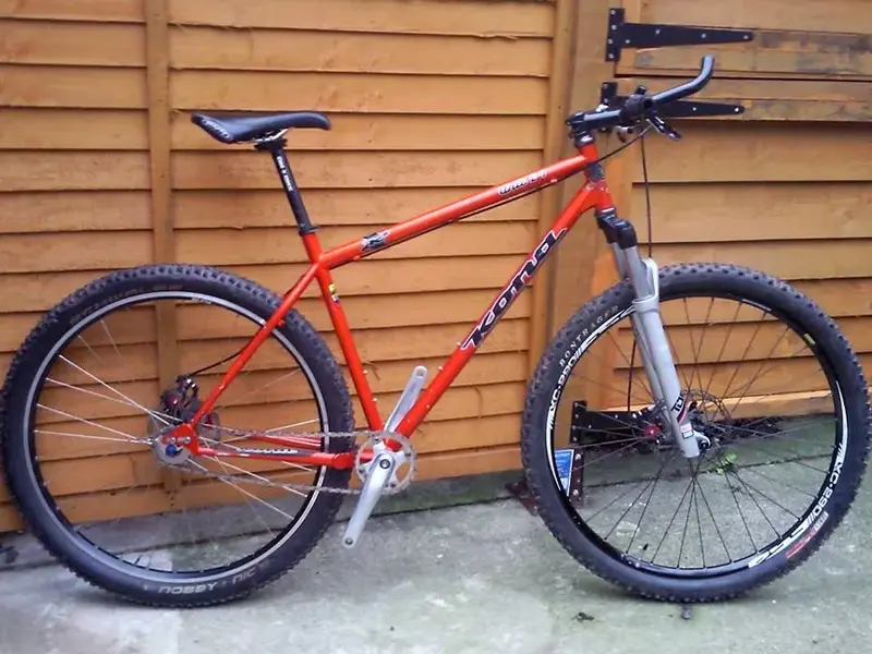

So I got myself a used 2008 Kona Unit 2-9 20" with 100mm Tora forks. Reach wise it feels good, I feel stretched out which is nice. But top tube clearance is nonexistent on stand over. I've looked at the frame size chart for that year and I suppose I could go down a size but then I would have a 110mm + stem on it just to get comfy. On the 20" I have the seat is right on the front of the rails to get my position right.
Another option is to put a rigid fork on the front which would drop it about two inches giving me some clearance. Or is it best to just get a smaller frame size with a long stem on the front?
Does anyone else ride with no stand over clearance?

I'm 6' 2" with a 34" inside leg. Maybe 100mm is the wrong fork for it?

Mm, doesn't look like you want anything shorter from seat to bars ;)
They originally came with a rigid fork, although it was a fairly long one to allow for a suspension swap -- I suspect they had 80mm forks in mind, but going 100->80 isn't going to make much difference to your standover. It's just unavoidably tall at the front, a lot of current 29ers have super-short head tubes to get the bars back out of orbit...

I know what you mean with the front feeling like it's in orbit. Feels comfy though. I'm thinking of putting a rigid fork on the front. Something like a 450mm, the current one is 510mm. So it should drop the front a bit to give me at least a little bit of stand over clearance.
Any ideas if you can get 80mm forks with a A-C measurement of 450mm? My back would appreciate something with a bit of bounce at the front.

Typical 80mm 29er forks are about 490mm static, so around 470 when riding. I suspect that's the length of the original rigid fork. I'd be wary of going really short on the fork on head angle/BB height grounds.

The forks are basic Tora, with no adjustment. To give me a rough idea I put a 26" in the front to see how it would feel with a lower front end with a shorter fork. I had about 2-3" of clearance. But I think I may have to swap the frame for something smaller.
