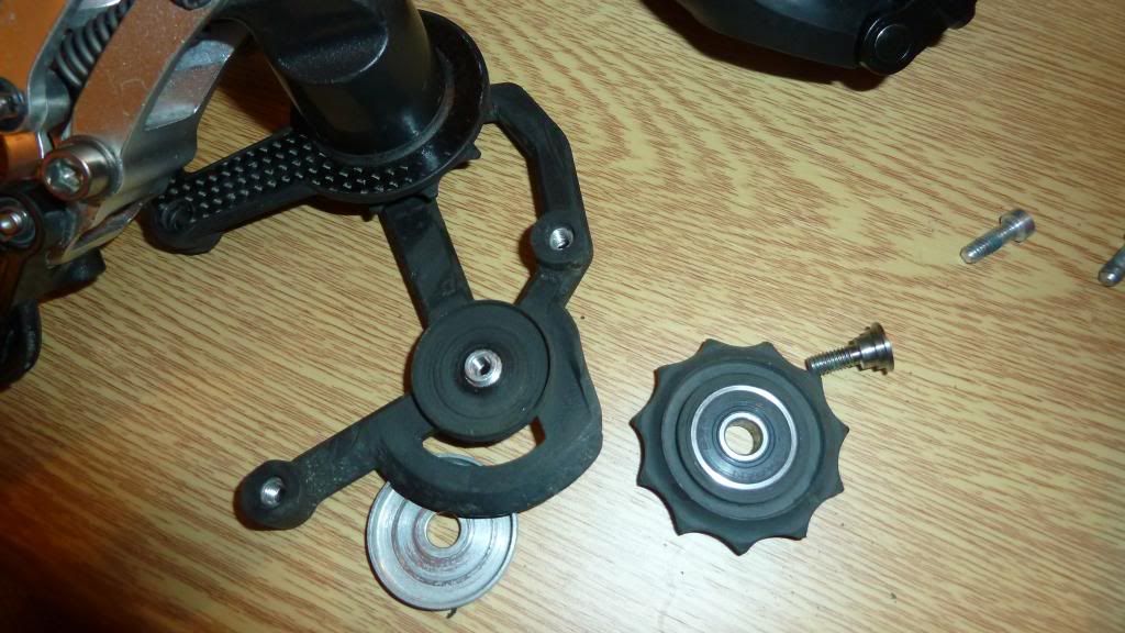

I have an x0 mech and wondering if there is anyway to put in normal jockeys?
Currently like this:

No. You'll need SRAM compatible ones. I have an X.0 with BBB jockey wheels and it works just fine.

These?
http://www.ebay.co.uk/itm/NEW-BBB-Rollerboys-BDP05-Jockey-Wheels-For-SRAM-Mechs-/180717504101?pt=UK_sportsleisure_cycling_bikeparts_SR&hash=item2a139a4665
Arent the bearings inner diameters too big?
The thing i was thinking was if i could remove the plate bits attached to the cages, thats the only hinderance?

Yes, that's how they look like, but just make sure you also get the correct covers. Mine came with 2 versions. I wouldn't mix if I was you. Also, I got these because they seemed cheap and I couldn't get original ones. If you can get originals, go for them!

I have the covers (attached to cage 2 are and still got the other 2).
Cant find originals though.

BBB rollerboys work great they come with a bag full of adapter plates to fit every conceivable mech :wink: :D

My 2010 XO rear mech took a pair of Hope pulleys no problem.
Earlier alloy caged XO mechs are a little different and won't even take the later type SRAM pulleys though.

99% sure these would do the job if they had any in stock :roll:

that's weird or must be an older model.
I have fitted 11T alloy jockey wheels without any compatibiltiy issues.
