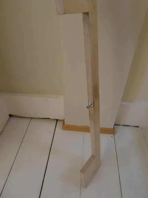

If anyone is interested, here's a pic of my home made dishing tool - just three pieces of ply, a tee nut and bolt.
Thanks
