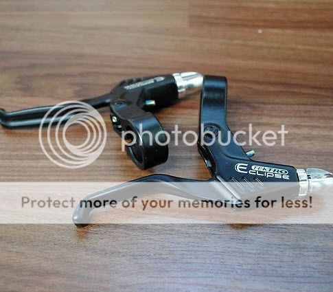

Just installed a front caliper.. centered it with a business card. The lever is a tektro copy of the official Avid lever. I set the cable tightness to just off of rotor contact, and when centering/adjusting set the inside adjustable pad back one click from same. With all this i was expecting great braking power from only a little movement of the lever.. and yet it needs to nearly touch the handlebar to really get grip. Am i missing something?
Levers here
