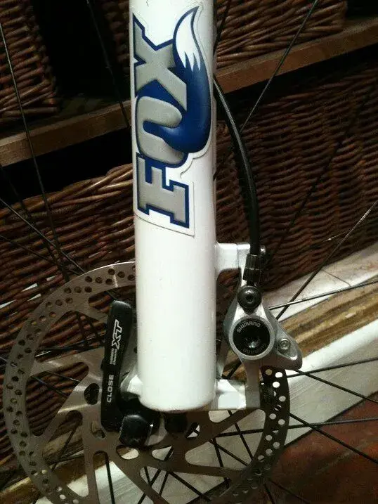

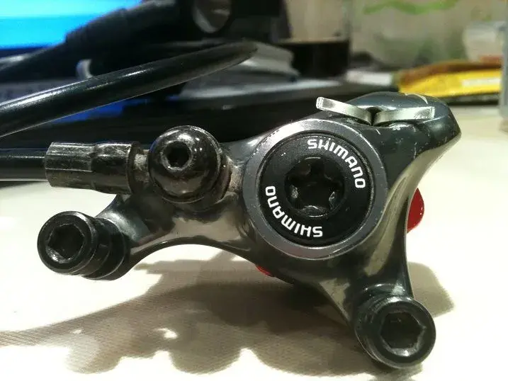

Ahh the pictures are making it clearer... here are pics of my forks (with current XT caliper) and then the new XTR caliper...

yep, forks are "Post' mount, caliper is 'IS' mount
