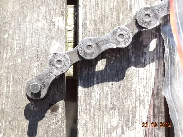

PostPosted: Sun Sep 23, 2012 9:02 am
Joined: Mon Jun 14, 2010 9:06 pm
Posts: 4861
Location: Herts UK
you usaully - or used to - get a spare pin when you bought a shimano chain.
£ 1 for a pin - what I remember themn costing - is outrageous!!!!
here is the photo. I have split and rejoined the chain twice now - it is on the commute bike so we'll see how long it lasts. :?
I believe this is the original joining pinm the the replacement break away type as it is flat on both sides - seem to rember the breakaway pin being dimpled on one side and then once fitted, have a waist where the bit that is broken off was attached.
PostPosted: Sun Sep 23, 2012 6:07 pm
Joined: Sat Oct 03, 2009 2:37 pm
Posts: 1738
Location: UK Southwest
That looks like the original joining pin. It won't be a break away type as it doesn't need to be, it will have been pressed into the outer plate by a machine at the factory (so no need for the breakaway guide). New Shimano chains come like this with a pin all ready pressed into one of the outer plates at the end. The oversized joining pins with the breakaway guide are for re-joining chains that have been split.
