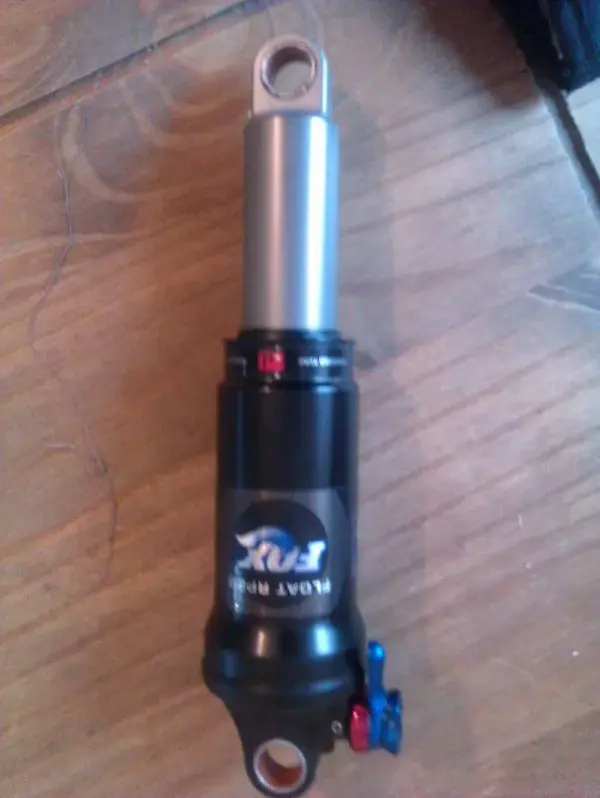

I've got a Fox RP23 Shock 190 i2i and 50mm stroke shock that i no longer need, good condition only done a few laps around the Verderers.
Mojo Suspension have the bushes you need 22m8(but you better check your bike just in case)
Good luck :)

Thats a large bush??
PostPosted: Wed Aug 29, 2012 11:20 am
Joined: Tue Oct 11, 2011 11:18 pm
Posts: 741
Location: The FoD.
It's a 13mm bush, is that bad?
PostPosted: Wed Aug 29, 2012 11:24 am
Posts: 741
Location: The FoD.
Just googled it 12mm and 12.7mm are the two common sizes so considering i used a 20 year old tape measure i can safely say it's a 12.7mm.
Panick over :lol:
