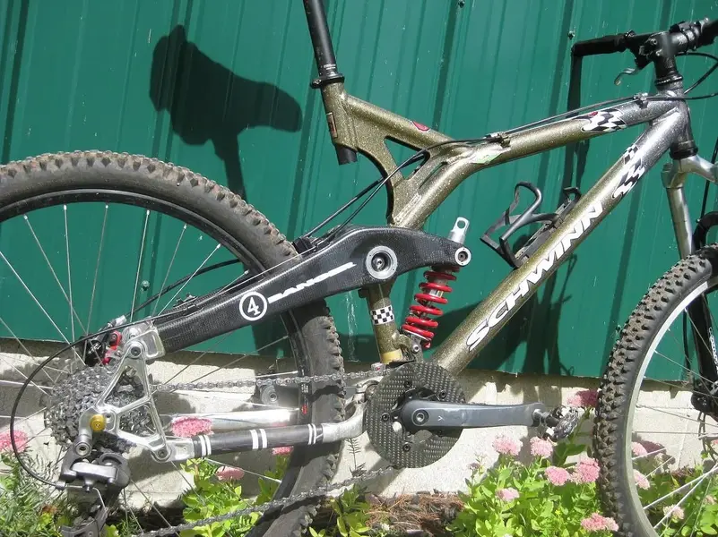

I've seen 4 Bangers which have been converted to Straight 6's by using nothing more than a longer stroke rear shock.
The rear shock on a 4 banger is a Rockshox Deluxe (Coil), with a trunnion top mount and a 1.5" stroke (I think). I'm guessing that, so long as you could find a 2" stroke shock with threads for a trunnion mount at the top, then it would fit provided the threads are in the right place for the trunnion to mount to the frame?
The shock which is currently fitted. Hopefully this should clarify what I'm on about:
I've had a quick look on some of the other forums to see what people say. I just wondered whether there was anyone on here who owned a 4 Banger and knew what to do?
Thanks :)

You don't need a specific shock for the trunion mount. I just found a regular 2" stroke shock on ebay, although it barely had enough threads on it to work. With the longer fork it should be ok.
I have always wondered what other brands of shock would work with the stock trunion, it would be nice to have more modern options.

Barneyballbags wrote:
Thanks for the info - I did see your Homegrown when I was having a search of the forum before - very 8)
I'd assume that any Fox coil shock would work then, provided the dimensions are correct..?
I think Fox uses a different thread pitch on the shock body so it will not work with the 4 Banger trunion.

Are there any air shocks which can be used with a trunnion mount.. Or is that a stupid question.
I think a decent air shock would completely transform it :)

Someone on the mtbr Schwinn forum made an adaptor for a Fox, but it was pretty weird looking. Risse may have made shocks that work, they did trunion mounts for GT LTS frames.
There is of course the Sid rear shocks that came with some 4 bangers, mine came with one but quickly changed it for a coil.
