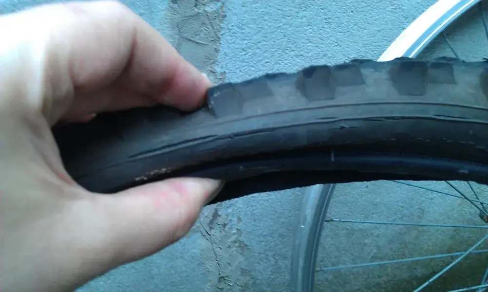

I knew that the old "Innova" tyres (see picture below) were way past their expiration date, so figured that they had really died now.
As soon as I'd get home, I'd take them off, straighten the wheel and slap on a good set of modern rubber.
(at some places you can actually see the carcass, so some of these cracks are all the way through the rubber)

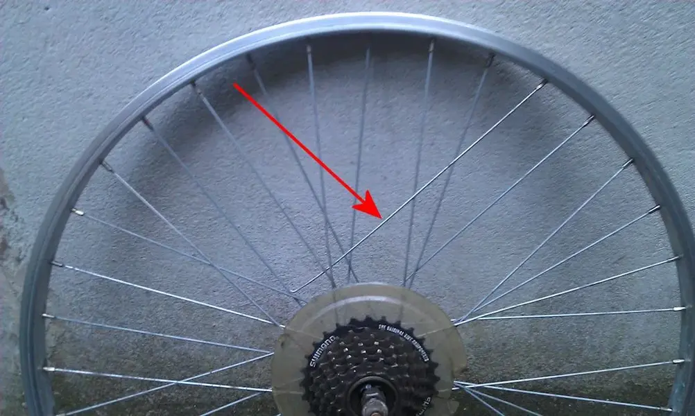

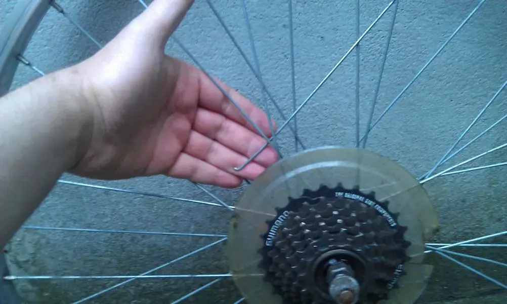

As I put the bike into the workstand, I noticed the wheel was more than 1/4" out of true. A quick inspection revealed why.
(I pulled it away from the hub for the pictures. At first glance you couldn't tell that there was anything wrong with the wheel)
I'll have the spoke replaced soon enough, but right now all the LBS'es are closed until Wednesday. However I really need the Trek for my work tomorrow and don't feel like putting the rear wheel from one of my Sbikes in there.
The other spokes feel and sound like they won't take too much extra tension anymore, so straightening the wheel by overtightening the other spokes is out of the question.
However if I remove the spoke behind the broken one (left of it in the 2nd picture), it should be straight (more or less) yet again.
So the million dollar question : If I remove the other spoke, would this wheel be safe for riding 40-ish miles?
FYI : 185lbs of rider, 38 lbs of bike and 25lbs of gear in the saddle bags, so close to 250lbs total, most of which rests on the back wheel.
The wheel was a 32h one, currently 31h and going for 30h if I'd remove the other spoke.

PostPosted: Mon Jul 23, 2012 9:17 pm
Joined: Sun Jun 10, 2012 10:35 pm
Posts: 46
Location: Tunbridge Wells
In my opinion of having seen this many times, when 1 or 2 supporting spokes on the drive side go, the others follow suit and break, removing the other spoke unfortunately does no make it straight, you will then have the problem of it going up and down, worst case scenario, brake pads rubbing on the tyre, not the best on a long distance with a large load
I have also seen many many bikes that have been ridden for yonks with broken spokes, most of them in London, crazy fools!
In the interest of safety I wouldn't advise you to ride it given your statistics
PostPosted: Mon Jul 23, 2012 10:12 pm
Moderator /Lincs, E & S Yorks Deputy AEC
Joined: Mon Nov 26, 2007 6:16 pm
Posts: 4183
Location: RetroModding™ since 1988
I'd agree, having seen many wheels come into our workshop with similar failures.
We start replacing just one spoke, then another one breaks, replace that, another one breaks...
I'd get it fixed or find a spare wheel

So a full rebuild or replacement it is then. Guess I'll look for a replacement, as this is still a screw-on cassette and a size 15 wheelnut.
Sometimes I just can't believe that this was original equipment in 1998.
