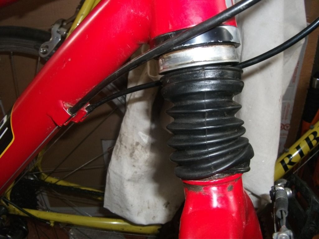

hi all i have alot of play in the forks,i know nothing about dale forks
should the cup be flush in the forks or has it droped down?,is it a big job and £££££ one
cheers :wink:

Everything looks like it is sitting where it should be.
Are the headset bearings ok? they are sealed cartridge, so they should feel smooth with no play
If its the headshock, they have lots of needle bearings in them, not for the faint hearted taking them apart, headshock forks do need a special tool to service once you've got the top off.
Cost wise it shouldn't be a big bucks to service, just depends on what they find on the way, damaged seals etc.

i got this on a whim not knowing about fattys and rushed in to it :oops:
dont know what im going to do yet,sell on strip parts ect,as its a 18" i dont want to spend to much on it and as bit on the small side for me
thanks for help :wink:
