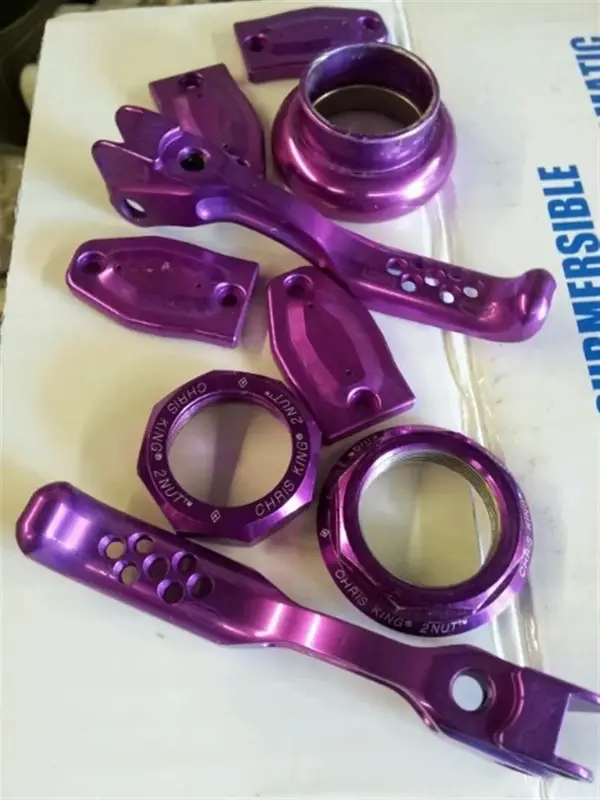

Talking of trick bore caps and things :wink:
