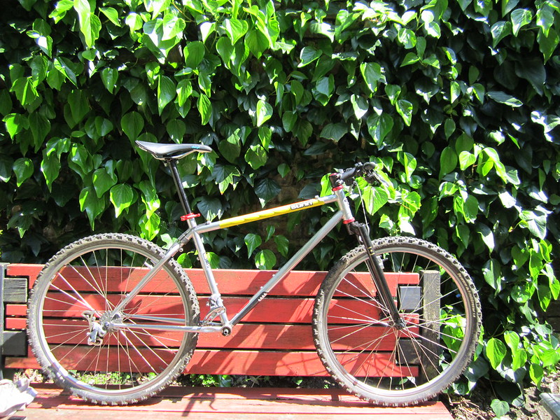

It will look like this with On-One forks on it. It certainly saves a lot of weight. This is a Total but is the same frame as the Xircuit but with a soft tail rear triangle. It should be 12Kg and with all the components upgraded to XT and the On-One forks it is coming in at 11.3Kg.
