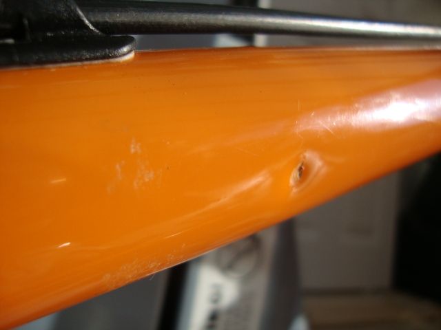

:shock: :cry: :facepalm:
Oh bugger.....
.....long story to how it happened...absolutely gutted is an understatement!
But...is it a problem? or should I just fill it and don't worry?
Its about 1.5mm deep. On the top tube, pretty central.

Cant see it being a problem really.
Steel is pretty strong, id trust this on alu so you should be ok.

If it hasn't pierced the tube it should be fine.

Looks like it's gone right through the metal :? If there's a hole I'd defo get it at least looked at before using again. bad times btw :(

Definitely hasn't gone through.... :?

Should be ok then. :D

Fill it with touch up paint, let it harden for around 4 days and then flat it back with t-cut. You will still see it but it will look like any other touched up stone chip. Touch up the other stone chips at the same time and after a few weeks you will have forgotten there is a dent there.
