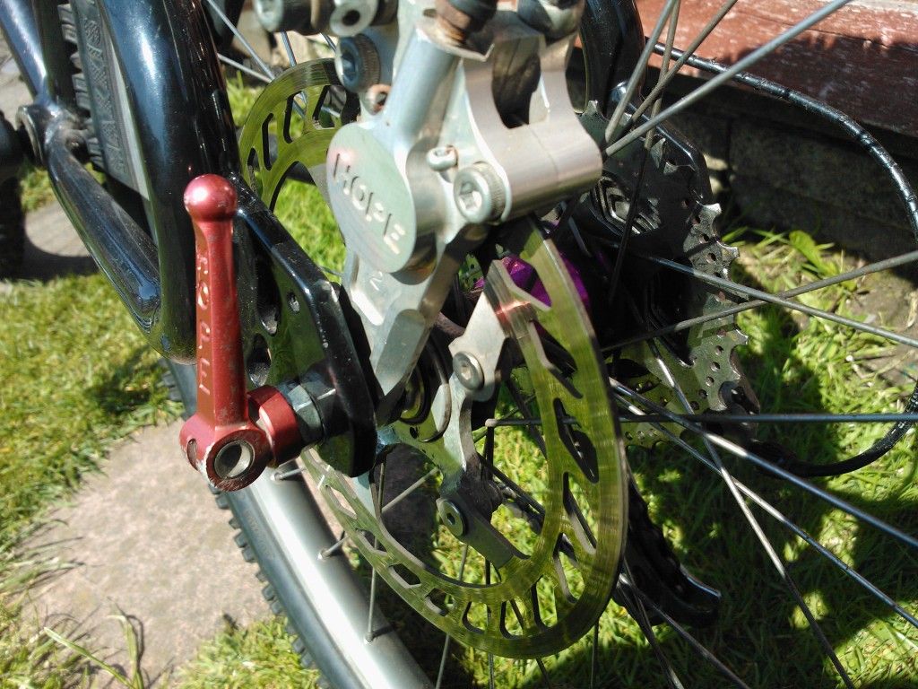

Hello, I have a very quick question which I'm struggling to find the answer too.
As standard what size discs do the Hope C2s come with?
I've currently got:
Number 3 Front 185mm?
Number 2 Rear 165mm?
Number 5 Rear (in the post). 145mm?
Trying mainly to figure out if I need to buy a +20mm adapter for the rear.

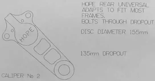

The number 2 is this type:

PostPosted: Sat May 26, 2012 9:29 pm
Joined: Fri Aug 26, 2005 9:41 am
Posts: 1259
Location: bedfordshire
i think that if your frame hasn't been fitted with iso tabs, and that your using the Hope 2 caliper with the torsion bar (a sort of factory bodge/solution) then because of the shape of the No 2 shell 1/2 being an integral part of the axle, you won't be able to add the +20mm bracket to run a +20mm rotor.
i have that caliper in the rear of my frame and it runs a 155mm rotor...
are you after a larger rear rotor?
is that photo your frame or a reference image?
PostPosted: Sat May 26, 2012 10:07 pm
Old School Hero
Joined: Fri May 25, 2012 6:53 pm
Posts: 233
Location: Ealing, London
Yes that's my frame. I'm changing to a frame with disc tabs (Merlin Malt 3).
Therefore the 2 is going to be redundant and replaced on the new frame with a Number 5.
Just wanting to make sure that I have all the parts necessary to piece it all onto the new frame.
The main question being what size disc the Number 2 is currently running, which I believe is a 165mm, and what the standard number 5 runs which I believe is 145mm. So I can double check what size adapter I need to purchase if that makes sense? Which is looking as though I need a +20mm adapter?

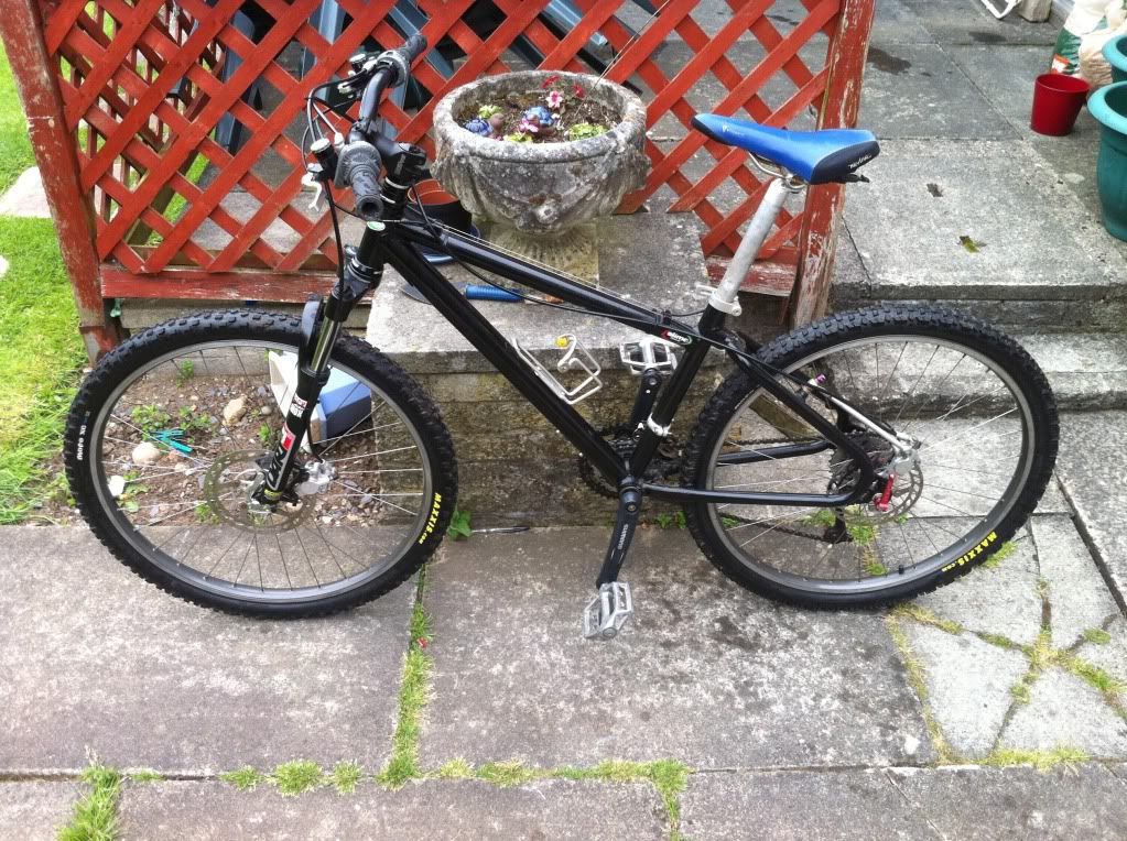

P.s. This is my bike:
The frame is 16" I think it's too small for me as I'm 6ft1, so I was going to buy a 19" merlin malt 3 and change a few bits in the process.
PostPosted: Sun May 27, 2012 6:49 am
Joined: Wed Jun 20, 2007 11:19 pm
Posts: 7006
Location: Odense, Denmark
You are correct.
No. 3 is 185 front, 165 rear
No. 5 is 165 front, 145 rear.
PostPosted: Sun May 27, 2012 7:31 am
Old School Hero
Posts: 233
dbmtb wrote:
You are correct.
Great thank you!!
+20mm adapter it is then.
Thanks for everyones replies!!

There is a hope chart somewhere on this forum.It shows all the hope caliper numbers with the rotor sizes front and rear,inc all the weird stuff.
Where it is i do not know.I lost the link but know its somewhere on here i just cannot be arsed looking for it any more.
Pretty sure the No2 is a 155mm rotor though :?

PostPosted: Sun May 27, 2012 3:37 pm
Old School Hero
Posts: 233
I go for a couple of mm clearance above the rotor,though i should think you can go a wee bit under that :? C2's are big powerful brakes so getting 3/4 of the pad surface to contact the rotor should be ok.Any less than that and you could have the pad vibrate as it wears,and starts squealing :?
Thanks, the number 2 has been confirmed at 165mm :)

http://www.oocities.org/ti_guy.geo/hope_faq.html#C2

find one of each[+ I have both :lol: ] Just in case the 155 doesnt fit and its a later/earlier/special/weird model
If you onlyh have a 165mm and it is too big then your completely stuffed and be needing a 155mm
However,if its the 155mm you have and it turns out to need larger,you can at least still set it all up for spacing.
which hub is this going with :?
It was really only the 5 bolt spiders that came with that damned troublesome+5mm[ 155mm /165mm/185m/205mm etc]The later 6 bolt for the most part are 160mm/180mm/200mm etc
Its not as confusing as it sounds,im just rubbish at explaining things and go into too much detail :oops:
Keep us updated and we'll keep the helpful hints coming :wink:
