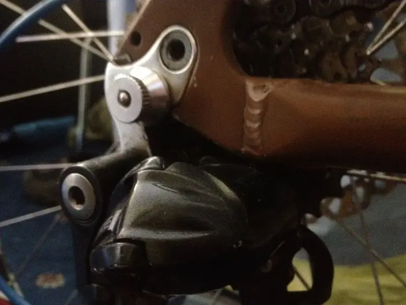

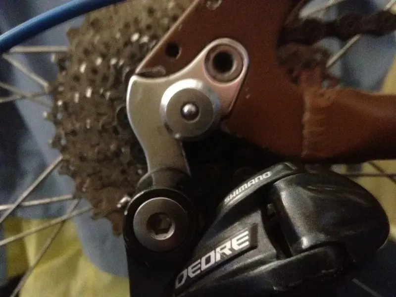

PostPosted: Mon May 28, 2012 2:47 pm
Joined: Mon Oct 17, 2011 8:56 pm
Posts: 298
Location: Oxfordshire
crossland wrote:
could be the cables pulled through or stretched a bit.
check the cable tension with the chain on the bottom cog. you can add angle to the rear mech by pulling the cable through a bit. but not to much as it will start missing the bottom cog if you do.
any pics of your problem?
Finally taken some pictures, sorry about the quality

PostPosted: Mon May 28, 2012 4:54 pm
Devout Dirtbag
Joined: Sun Apr 22, 2012 1:22 am
Posts: 123
Location: north nott's
one way or another, you need a bit more angle on the mech.
does the b screw actually do anything? apart from resemble cheese that is :D . that can easily be replaced with a nice stainless cap head btw.
the b screw or cable tension will be the answer. how is the tension when on bottom cog?
PostPosted: Mon May 28, 2012 5:35 pm
Joined: Sun Aug 21, 2011 11:57 pm
Posts: 4192
Location: Antwerp, Belgium
You need to adjust the screw near the dropout. The one that actually touches the mech hanger.
If adjusting it (screw it clockwise) doesn't tilt the mech into a position where you have more clearance, the internal spring is most likely broken. In that case I'd suggest changing the mech. It's just a Deore, not worth mourning really.
