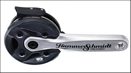

Pricey (£450ish) but you could get a Sclumpf MountainDrive to replace the chainset and BB. It would last a lifetime of bikes, though.
1:2.5 dual speed gearbox for the front...
Or a Truvativ Hammerschmidt, a bit cheaper (£350), but hardcore DH:
