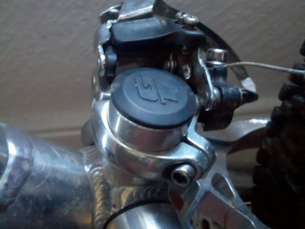

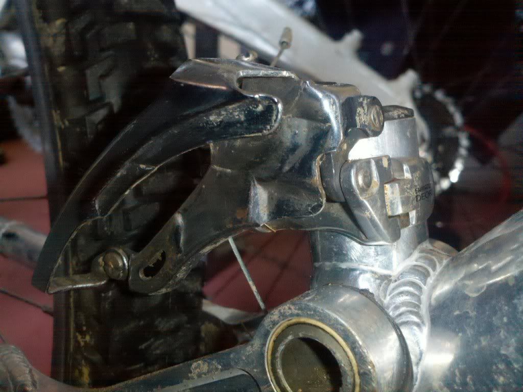

If it's a curvy frame LTS like mine http://www.retrobike.co.uk/forum/viewto ... highlight=
You need a big, low clamp, bottom pull mech like this, http://www.retrobike.co.uk/forum/viewto ... highlight= if no-one else has a piccy i'll post one up in the morning (not near the bike at the mo)

Here's my '98 LTS 1000 (excuse the muck, just starting a strip and spring clean :lol: )

thanks for the photos

I just had a looksie on CRC, you want a 'top swing' mech but I see they only have 9 & 10 speed one's so if you're after an 8sp (slightly wider cage) you'll probably be best off putting a wanted ad on here :D
EDIT: Just found this... http://www.evanscycles.com/products/shi ... e#features Alivio 8sp multi fit should do the trick
