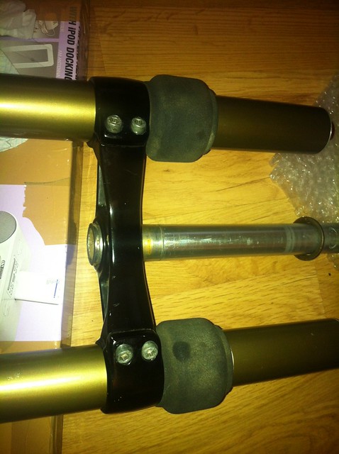

Have a set of Monster T, so I'm talking about 4 M5(?) in the main crown/steerer clamp, couple in the upper crown (no load) and then six M4 in the M brace.
I can't see three a side failing the the M brace, upper crown has no load/importance leaving the only risk the lower crown ones would fail and the frame would slide right down the forks. Could be hilarious or could hurt quite a bit :o

Only two bolts per side here but anyway, I just want to replace steel with alu. Obviously less strength but are they strong enough to replace steel..? :D

I would never recommend aluminium bolts were used in safety critical areas such as this.
I'm sure an engineer will come along soon to disagree with me though :)

I wouldnt use aluminiums bolts in a place like that, Definately Steel ones :wink:

I used SS in my brakes but I think this may be different. There is no shear force, just a straight pull on the clamp across four bolts.
The alu bolts have a tensile strength of 570mpa (ProBolt UK) which is pretty close to steel and it doesn't look like the stock bolts are high tensile steel either.

The problem isn't the tensile strength, but fatigue. You won't know if one bolt has cracked through, placing all the load on the others - pretty soon that will go too and the thing might be held by only one bolt.
The weight saving is peanuts, the loss of reliability is huge. There are very good reasons why people don't use Alu bolts in regular things. :shock:
They are OK for F1 cars etc which get stripped after every race, not for real life.
