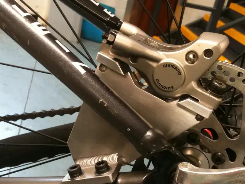

you need a mmount like this

hmmm, I'm not so sure. look how long the lever is from the calliper to the chain stay - that is putting quite a bit of torque into the chainstay contributing to early failure - there have been occurences of chain stay failure with this type of frame design.

There isn't the slightest flex or anything and it works s treat and bites the rotor better
