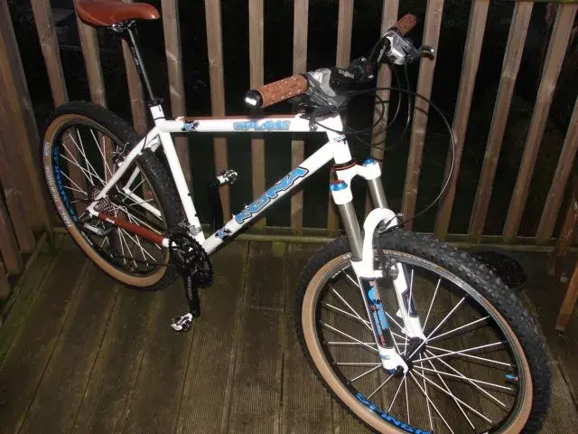

To be honest i really rate it.
Effectively "True Tempers" answer to Reynolds 853.
take a look...
http://www.retrobike.co.uk/forum/viewto ... cafe+racer

cheers, sinnerman :)
looks good, the one you did.
my idea was to have a disc'd steelframe and I love the Kona geometry, but did not want to have a disc tab welded to a, lets say a 96 Explosif, I stumpled across a 2003 Explosif bike. If quality of tubeset is as good as 853, than I should give it a go.
Want a lightweight CC/marathon bike, so thinking about using a SID and some XTR 96x stuff - will report here.
