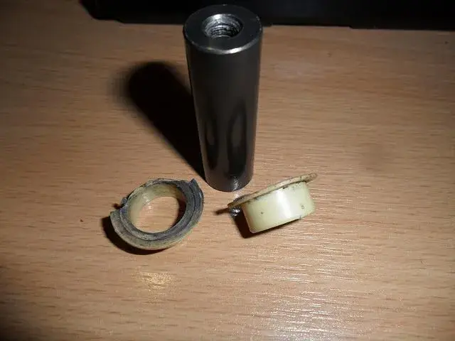

the plastic bushes - top hat shaped (pic below) - i'm looking to get some of these made and am wondering if nylon would do the job?
anyone have an idea of what the originals are made from.....

Location: Edinburgh
only known them as nylon bushes/ bearings so would assume they are nylon
my old seatstay still has the betd roller bearings fitted, cant find the little o-rings that fit on ends where it joins chainstay
maybe sell/ swap it if i find the o-rings

Location: Newcastle
Not sure either, although i may be intrested in some replacements, i was going to leave my bushes in over winter just so i have less maintence for any bearings :lol:
If i could replace all the bushes for new ones i may not convert to bearings at all?

Ta Carge! was a blinder of a frame in the first place :) already had some of my friends drooling over it :P
i'm thinking of converting the rest of the linkages to bearings (at least the chainstay and seat stay ones) but for now i think i just want to sort out these nylon bushes as its faaaaaaaar cheaper :)
i'm getting some help from a chap on this forum, found some nylon rod on ebay for a few quid, if they turn out ok on the lathe, then i may be lucky enough to have some spares i can dish out :)
not sure when it'll all happen, but hopefully within the next month - keep your eyes peeled, i'll update this thread if/when there is some success :)

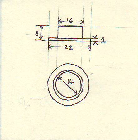

here are my measurements:
the bushes from the 'top of chainstay' look to be the same dimensions, but are longer (i.e. where it measures 8mm on this drawing, it looks to be about double that length) - need to confirm this though.
can't see any on that website that fit the dimensions i have, but haven't looked much yet.
i got some nylon rod off eBay for less than a fiver, if it works, then it may work out a worth while venture :)

Hmm, these seam pretty close!
Dimensions +/- 0.2mm
C - 14.2mm
A - 15.8mm
B - 25.0mm
D - 4.0mm
E - 2.0mm
http://www.bpfittings.co.uk/pc/14-2mm-I ... 6p5911.htm
But they are not tall enough, i suspect they may work though?

possibly, but would be a bit of a gamble. will know [hopefully] in a few days if my nylon rod can be turned into some useful components!
may also be going for the 'top of chainstay' bushes too.
would be nice to make the complete set and have the a-links re done, but i'm thinking of leaving them as they look fine.
