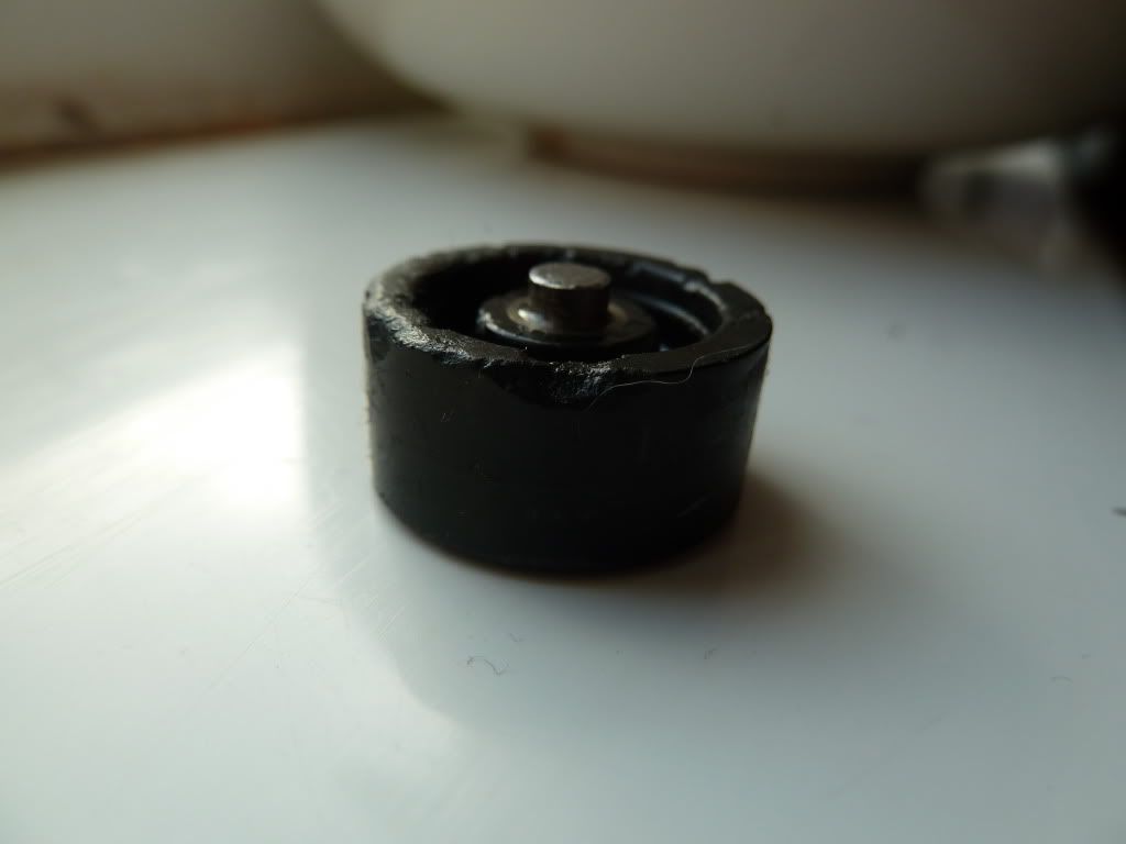

Was servicing some brakes on here recently as on side ha dthe dreaded stuck piston. Tried everything to get it to return to no avail but in the process have chipped the piston. Got it out with a track pump in the end (ask if you need the tip). Just wondering to re use it or not? (Biggest chip shown).

file under b 1 n.

Thats what i was thinking also!
While we are here, im thinking of changing tactis. I was planning on greasing the seals rather than using brake fluid. Opinions?
That looks like a Hayes 9 piston.
Fairly cheap from chain reaction.

They do look very similar yes. Havent checked diamters and stuff but the nipple bit is different on each.
