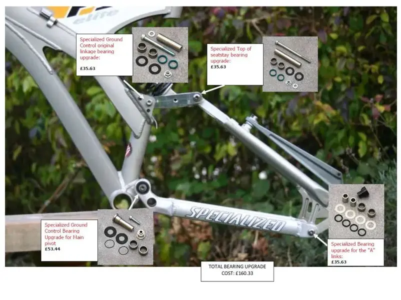

i'm an idiot, so i put this together when figuring out what i might want to upgrade on my linkages for my Spesh FSR....
(image courtesy of Carge, prices courtesy of BETD)
hope its of use to someone else.....:)

i have a feeling you could make your own sets for less, but is it worth the extra hassle?

£160.00 would get you a better frame with sealed cartridge bearings

how would one go about making their own sets? i'd assume you'd need the measurements etc....?
not interested in getting a 'better' frame, that would defeat the object of upgrading [and keeping] this one....:P

sealed cartridge bearings are cheap as chips.
you'd just need measurements, and potentially access to some metal working tools.

im sure the 2001 enduro bolts and cartridge bearing kits would do the job and cheaper

i'm not sure how i'd find that out, there's loads on ebay, but not sure where i'd start to see which ones are compatible?!?!?

this thread shows the enduro overhaul looks the same as GC to me
http://forums.mtbr.com/specialized/fsr- ... 26577.html
you need a log in to see photos
mines is a mix n match of spares from my s-works bolt kit and the betd rollers and the enduro bearings

owner of both a '98 FSR & Enduro here, there are some similarities in the 2 machines but i honestly don't think an enduro bearing kit will be 100% useable on the FSR.
some of the bearings will no doubt fit, but the linkage on the FSR & Enduros differ fairly significantly.
