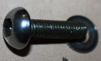

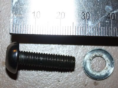

Right here are two pictures of the bolt in mine
Hope this helps

Joined: Sun Jul 31, 2011 11:24 pm
Posts: 334
Location: Bognor Regis
thanks alot i think i've just found it, been ripping my hair out all afternoon :)
