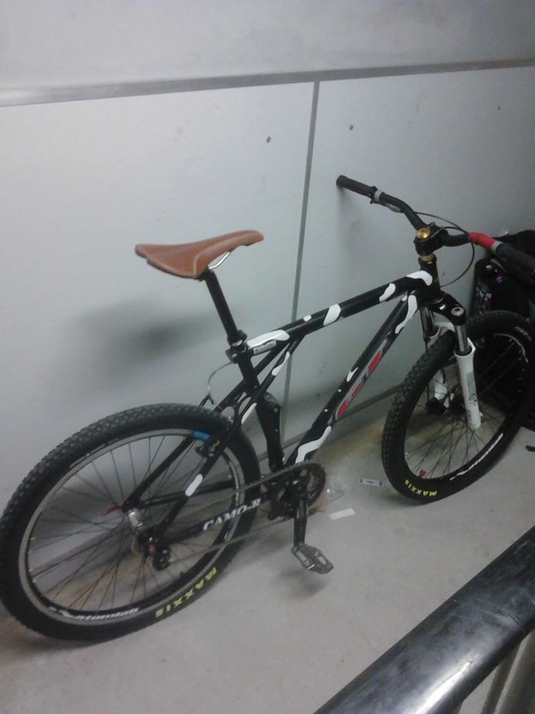

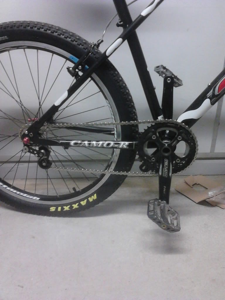

just adapted my zaskar to single ring at the back and a double up front.
my reasoning is that i will be using it mainly to ride to work. on the way its is down hill and on the way back up hill obviously.
ratio's are 36:18 and 42:18 so should be a nice spread.
tensioning is by a rohloff jobbie. they really live up to the hype.
pics :D

nah just change it for the kind of riding you are doing. will probably keep it in 42:18 for road and 36:18 for off road.
now if only i could coble together some kind of handle bar mounted device to change between the two front gears. possibly using cables.

Regards chainline, the rohloff has a floating top jockey wheel so no issues. Only the same as running gears.

Beyond the argument of "because you can", this seems a pretty pointless exercise.
I can just about get my head round singlespeed on a dedicated frame with resultant weight savings on a particularly open-minded day. But this - you've only saved the weight of the extra sprockets, shifters and front mech which don't amount to that much. And chain slap will suddenly be an issue, as will chain line and dirty fingers when changing gear.
