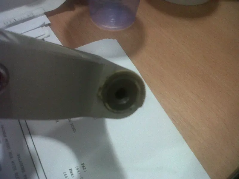

how do i go about removing this part if i want to upgrade to the BETD needle bearing kit?
the plastic washers broken on the shock link as well (the part that attaches to the frame)........

i am a little bit unsure of exactly how to remove what looks like the threaded rod thats in the shock linkage. cant really see how it would come out, unless i take the top hat spacers out, partially screw an allen bolt in there and pull/tap until it comes out...???
PostPosted: Sat Oct 29, 2011 11:40 am
Gold Trader / Special
Joined: Wed Aug 27, 2008 3:48 pm
Posts: 3169
Location: Leicestershire
i'm struggling to figure out which pivot that is.
need better pics to enable a diagnosis. :wink:

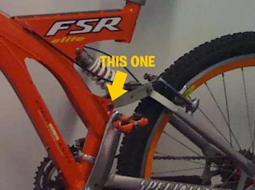

rather conveniently, i have found this image which explains perfectly the part of the link i am on about...
PostPosted: Sat Oct 29, 2011 5:15 pm
Posts: 3169
from looking at the BETD kit pics, the bar shouldn't have any threads on it.
if you have the right size socket you should be able to use it to apply enough force (mallet etc) to knock it out enough to be able to get a grip on it and fully remove it.
also by the look of it the BETD kit it contains everything you need, so anything removed should be surplus to requirement.
it should come out without too much trouble, unless of course it's siezed up.
in which case you'll have to give it some which will no doubt end in the removed parts being fooked and no doubt a degree of blood loss on your part. :lol:
