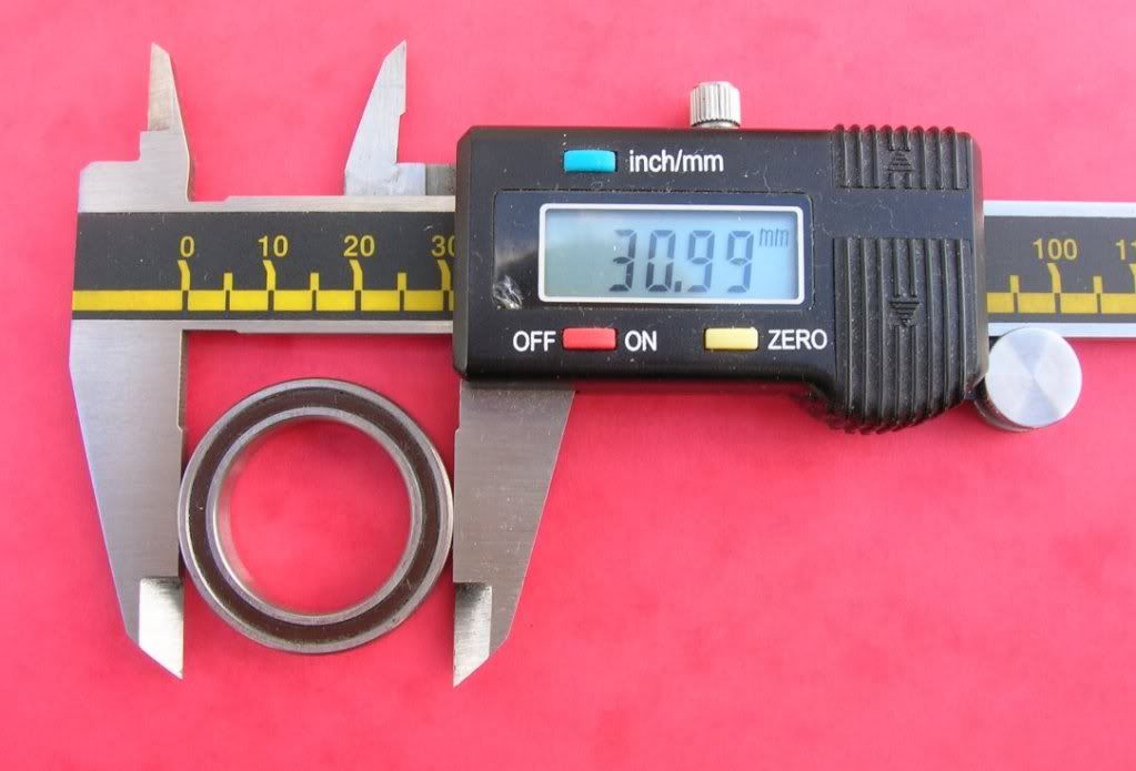

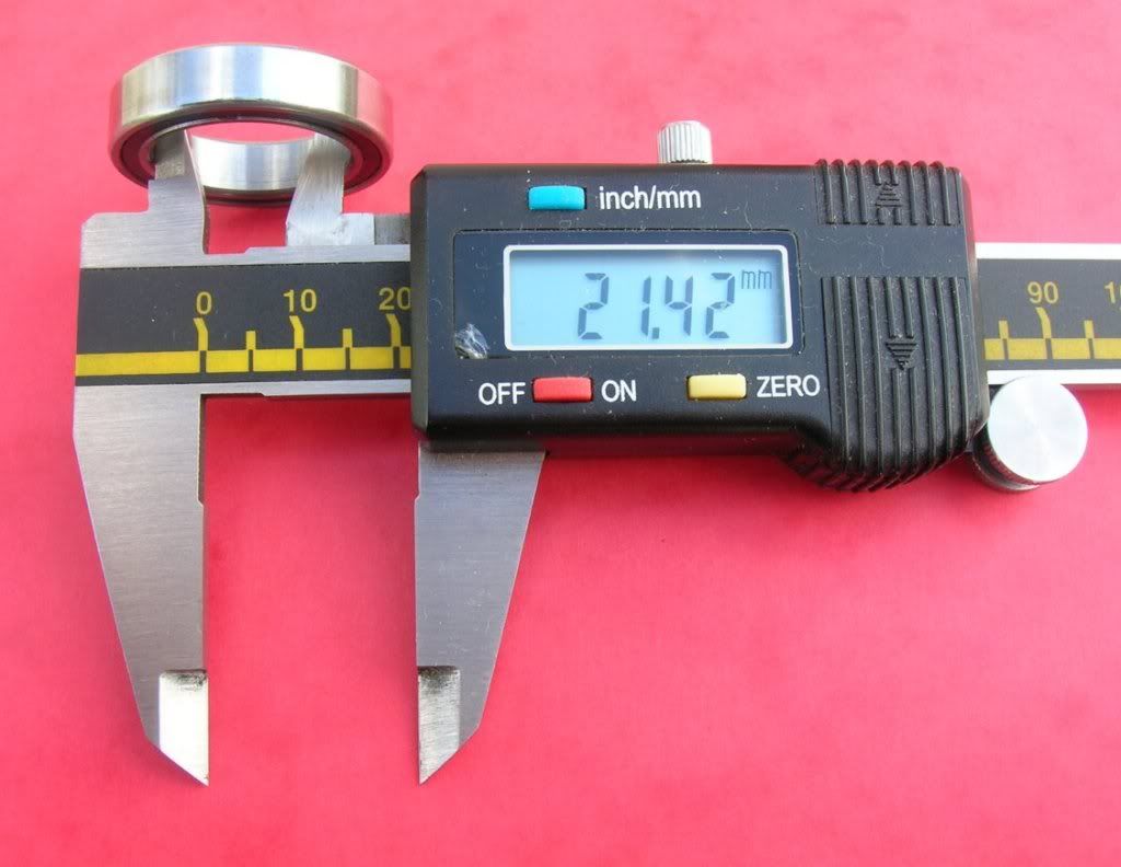

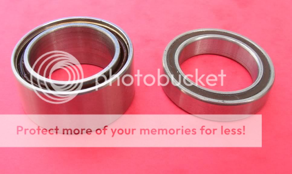

Hi there,
I got a set of bearings from BETD to re-build an FSA Platinum Pro Ti ISIS.
http://www.mountainbikecomponents.co.uk/contactus.asp
I phoned them as they were not listed on their site.
I just took some pics - I assume these are the ones that I removed.
Pip.

Any code on the black seals?

Hi there,
Sadly there is no code on the seals.
I have dug out an invoice from BETD, which may be for the bearings that I bought from them to replace the ones in the pictures above. Blimey, my memory now!!
I'm currently struggling to read the hand written code on their invoice. It looks like I bought 3 bearings 7mm wide, and used 2 of them on the drive side to replace the 14mm seen in the picture above.
