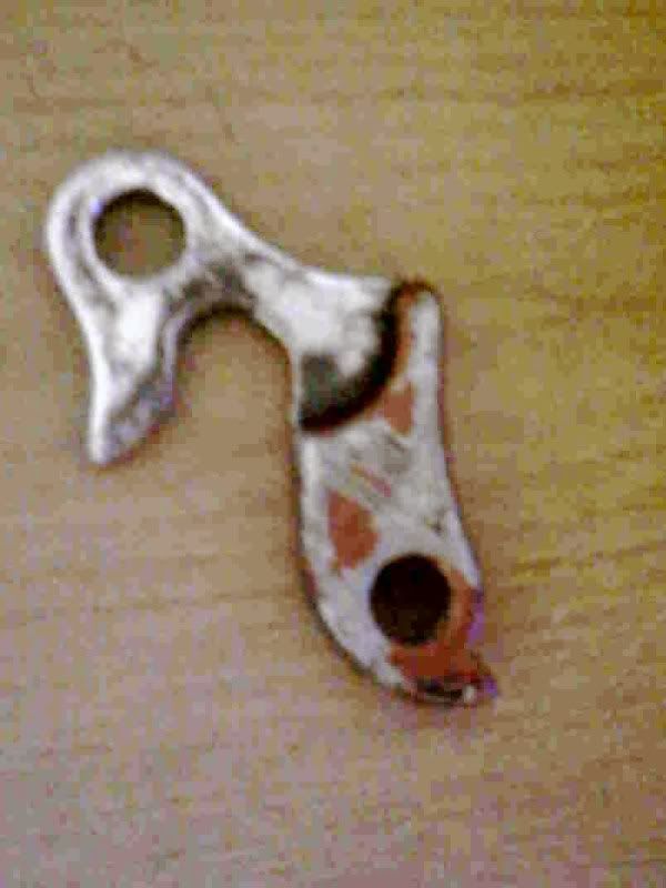

PostPosted: Thu Jul 14, 2011 10:03 pm
Joined: Tue Oct 07, 2008 7:18 pm
Posts: 716
Hi chaps....this is the mech hanger in question:
PostPosted: Fri Jul 15, 2011 9:44 am
Gold Trader / rb Rider / Special
Joined: Mon Aug 31, 2009 12:26 am
Posts: 16165
Location: Rurally close.
looks almost identical to hanger no. 27
http://www.mountainbikecomponents.co.uk/items.asp?CategoryID=201&Name=Marin+Hanger%2FDropouts
should fit
pricey though

http://www.derailleurhanger.com/marin.htm
