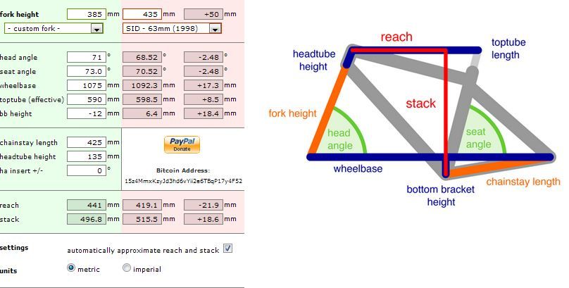

Hello, I want a simple EXCEL SPREADSHEET to recalc bike geometry, when a LONGER FRONT SUSPENSION FORK, is fitted.
Before you suggest a program/website, read below first to the suggestions.
Sounds so simple doesn't it! But it isn't that simple, because a bicycle frame isn't just trigonometry and Soh Cah Toa, because a bike frame isn't made up of RIGHT ANGLED TRIANGLES!

But I want an EXCEL spreadsheet to do the above for me, so I have searched the internet, and found three partially suitable programs/websites:
(A) ~ GeoCalc
http://bikegeo.muha.cc/
(B) ~ BIKECAD
http://www.bikeforest.com/CAD/bikeCAD.php
(C) ~ Martin Manning's Bicycle Geometry 101:
http://www.os2.dhs.org/~john/Bicycle_Ge ... 1_v801.xls
The above don't entirely meet my basic purpose, hence comments below:
(A) GeoCalc: SIMPLE and RELEVANT, compare current setup (L/H) with new LONGER SUSPENSION FORK setup on (R/H). However this does NOT auto calc that a longer fork will raise the bottom bracket higher from the ground, hence without this "correct b/b height length", then the quoted angles will be incorrect. With it, looks good.
(B) BIKECAD: PRETTY, WITH LOTS OF OPTIONS, BUT THE FORK OPTION EVEN IN CUSTOM MODE FOR A LONGER SUSPENSION FORK, does NOT auto calc the new HEAD/SEAT TUBE ANGLES, and neither does it auto calc what the new b/b height will be either. With it, looks out of proportion of the example I did.
(C) TOO MUCH INFORMATION, AND DATA TO INTERPERATE. I need something much simpler. Not criticising, frame designers may need this amount of detail, because obviously a frame is more then just lengths, it's curved tube sets, chain/seat stays, and a fork that clamps around wheels. Obviously there are many normal unsymmetrical (Not the same of each side) inclusions such as, a DRIVECHAIN SIDE (R/H) and a NON DRIVECHAIN SIDE (L/H), hence side specific rear dropouts with a gear hanger on Rear R/H dropout, gear and brake cable/hydraulic brake cable routing stops over the frame & fork, also there will be disk brake caliper mounts on the L/H (NON DRIVECHAIN SIDE) of the frame, and also the fork as well, etc. Also there should be bottle cage/crud catcher mounts, etc.
Q1. So does anybody have a simpler EXCEL SPREADSHEET CALCULATION/FORMULA to work out the new geometry after fitting a longer fork? (NOTE: To include new BB HEIGHT, HEAD/SEAT TUBE ANGLES!)

A bit like this
For 1" rise
HA = -1.25deg
SA = -1.25deg
BB = +.36"
give or take a bit depending on frame size. but tyre/weight on tyres/pressures probably vary that difference anyway.
That is for Front Sus only, Full sus is a different ball game as I assume the rear should counter the front then

On my Altitude (as you know that bike) it is designed around a ~390mm fork. (It is 1991 after all). But I've always ran MAG's on it, mainly as I got it that way, which at standard travel are 405mm in length, sag on these is negligible in use
But this drop the angle from 71 to ~68.5 (never actually measured it)
But on your other post I added a screen grab. Measurements are not quite true, but somewhere near there
For about a year I've been using early JUDY forks, 60mm and these slackened everything off. It was ok for general riding, but it just lacked something and it wasn't quite right. So the MAGs are back on and it now feels 'correct'
So to me that is to much for my type of riding.#I could have tried a shorter stem to liven up the front but to be honest that wasn't the biggest problem. for me it was the seat position, I had to run it far forward to get to pedal position right for me.
But other consequences are the front is higher, the effective reach is reduced.
To compensate for the next few years the moved angles to 71.5, and same for the seat tube iirc. This worked with short travel forks until 60mm became norm in 95-ish.
top tubes also got longer a little (to counter the reach I guess).
I wouldn't go any more than the 60mm on these early frames, not least because it looks daft.
Now as you go longer you get other problems. How do you define the angle and manufacturers don't seem to state that.
Some might state it as off the bike (as the did when travel was down at 40/50mm). It could be after sag, or normal usage level.
You then get the problem if it's '71' off the bike, you're then step in use and get steeper the further down the fork travel you travel getting a twitchier and twitchier front end and sliding of your seat ;)
So when your at 100/150mm it get complicated and way beyond anything I know.
