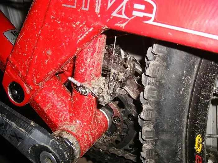

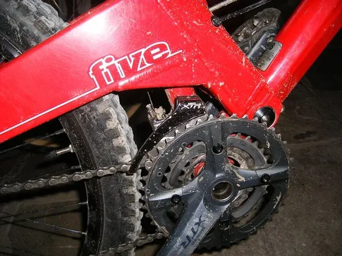

Always get top/bottom swing mixed up but my 2009 5 (and my old 2006) uses a 31.8 with the cable running along the top tube then down the seat tube.
Top swing are the type where only the cage is visible from the side if that makes sense.
31.8 sounds right actually as is a 27.2 seat post.

PM me if you need some info mate. I'm no expert but have had a couple of 5's.

Mine looks like this (yes, I know, it needs a clean! :lol: ).
