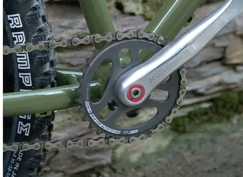

Nothing wrong with modern Middleburn, pretty much default choice for many, particularly with the neat Uno ring.
I like WI Eno too

Middleburn RS7 or RS8 or else any 94mm BCD crankset that you fancy, 94mm because you'll probably want to use a 32T chainring.
Square taper Middleburns/ SKF 600 series BB is as good as you get IMHO.
Shimano HT2 cranks can be got for not much money and, especially if you want to use an EBB conversion (Forward Components or Excentriker), are a good choice too. Get some roughish ones ('cos they'll be cheaper), cut off the granny ring mounting bosses and get the polishing gear out.......
Of course, if you have a frame with an EBB, track ends or sliding dropouts then you are free to use any crankset you want but either of the EBB conversions needs an HT2 type crankset.
