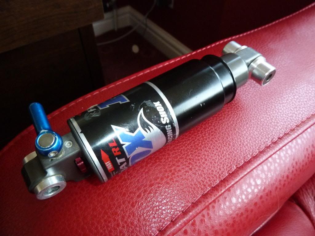

Hi all
Got a problem with my Fox rear shock... I cannot get the shock to move (other than around 2mm of compression)
It seems stuck at it's maximum compression. Also it won't lock out. With the lever in the lock out position it just does the same...
Can't seem to get air into it either and there was evidence of oil around the inflator valve...
It was fine (it's been fitted to a frame I'm building) but seemed to go funny when I put some wheels on the frame and pushed myself down the drive
Below are pics of current state and one of it fitted to the frame (A Tomac 98 Racing Special).
Any advice appreciated. Not used to working with shocks (all a bit modern for me!). It's almost like it's gone into a sort of limp home mode. :?

Wow, thats's not for the faint hearted - I'll get the wife to do it tomorrow for me... :D :D
Looks like the air gets pressurized on the wrong side... Is there a safer way to release the pressure 9and protect the shock innards?

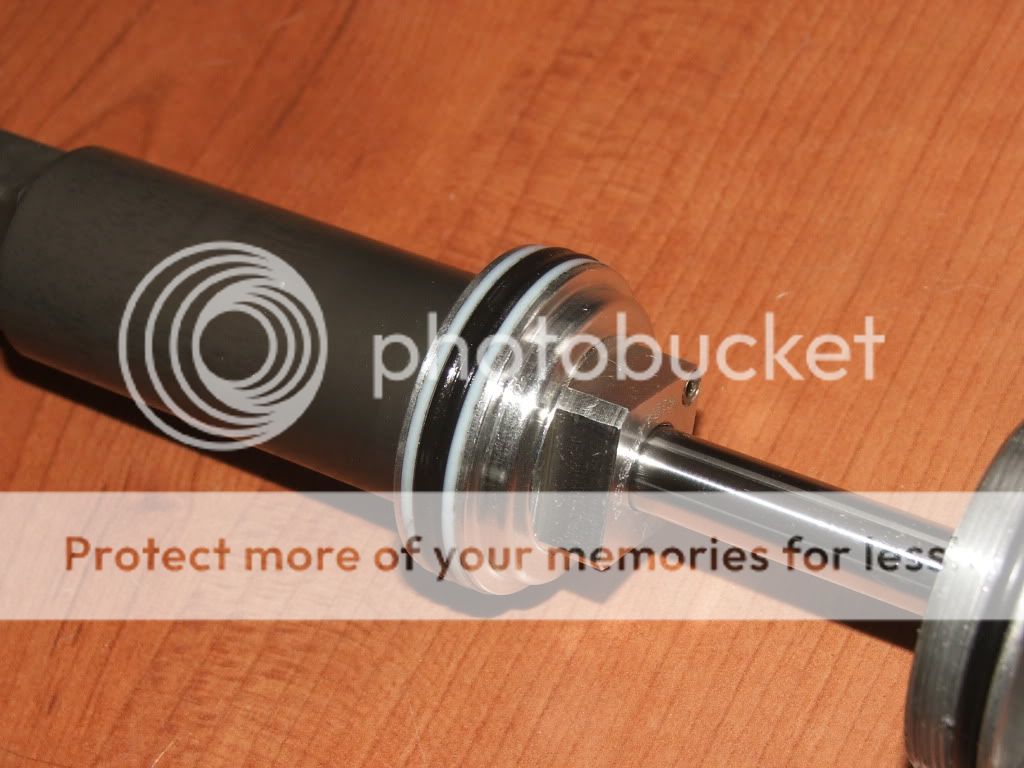

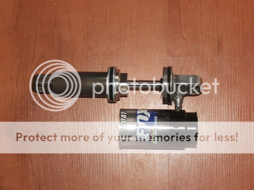

I have just serviced my float and its easier than it looks, all you need to do is unscrew the chamber (should only be hand tight) then stick a rag through the eye and pull the chamber with a bit of force, it will come off fast thats why the rag is there, if you need any help just pm me
This is the seal you have problems with, its letting air into the negative chamber but not letting it out
