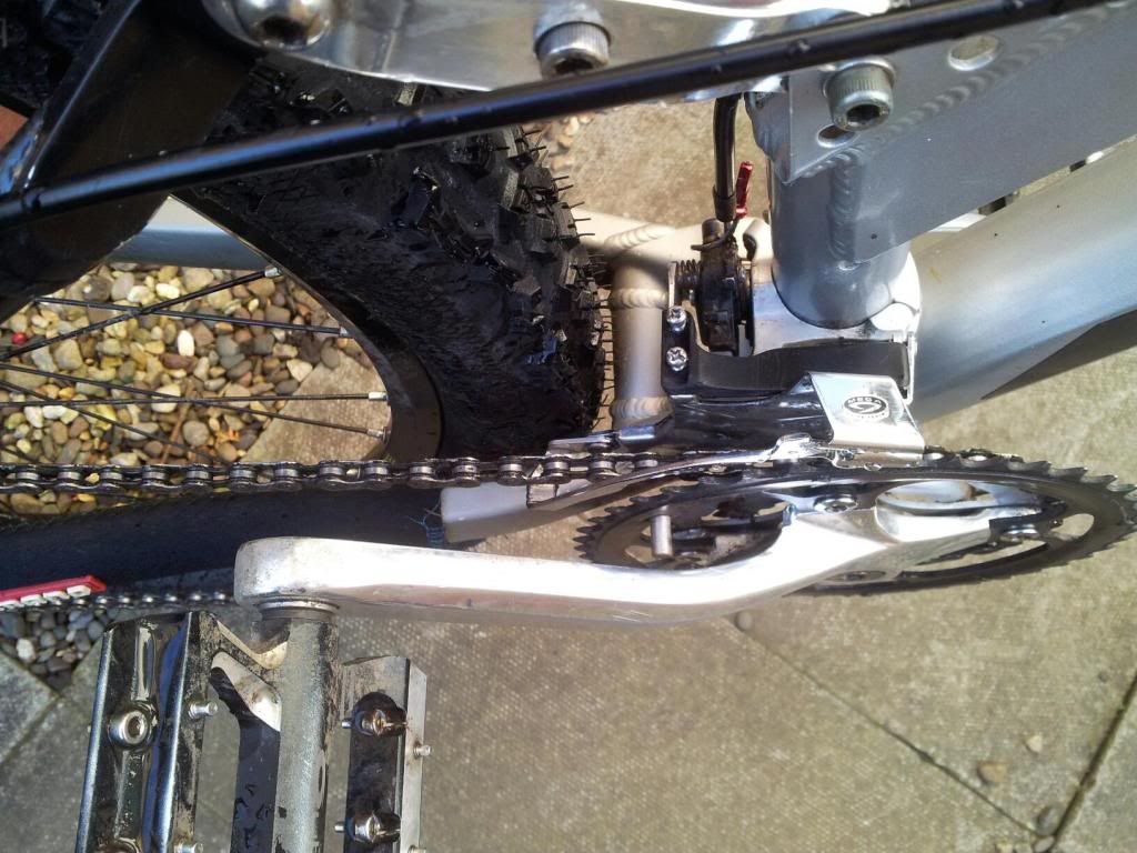

nicely put together that bike S-M.
Whats the clearance like on those tyres?
 Post subject: Re: Show us yer FSR's
PostPosted: Sun May 05, 2013 11:42 am
Joined: Sun Oct 14, 2012 8:26 am
Posts: 318
Was thinking the same 2.2 on the front, but can't see the rear? It must be close to bottoms of swing arm/bottom pivot

2.2 Continental front and rear
Front is a Rubber Queen
Rear is a Mountain King Mk2
2.2 Rubber queen will fit on the back (just!) but it leaves very little clearance for mud, and to be honest, the MK tyres roll a hell of a lot faster for me.
I always liked the way the MK tires roll nice and fast, but fitting one to the front for me always made me nervous, the amount of times i had the front end wash away from me was unsettling, the Rubber Queen on the front gives the same initial wash out feeling, but they have ALWAYS found grip and got me around the corners.
You could get away with fitting a Rubber Queen on the rear in the summer as long as it stays dry, pointless in the winter though, they are a little bit draggy, this is on an Elite Max backbone frameset though, iirc the chainstays are beefed up a bit, not sure if the other/thinner stays would offer more room (but they always crack so i`m not intrested in them :D )
That photo is a 2.2 Rubber Queen on the rear of my bike, the little knobbly bits actually started to rub the paint away, and as soon as i got some mud on the tyre the chainstay paintwork was ruined, i stripped it all back, resprayed them silver and had the decals replaced.

Are you fitting the Rubber Queens to a bike like mine ? :P
You did see the picture i posted? yes they fit, just!!
Expect your paintwork to get rubbed as soon as anythng gets stuck to the tyre on the rear! :D
