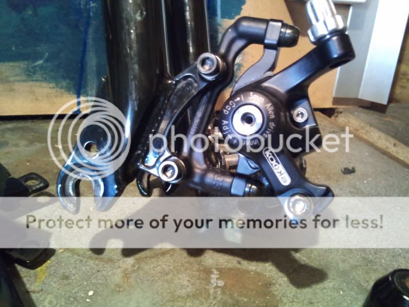

I think the adaptor is meant to convert it to a rear?? But it looks like it'd work like this (there's an arrow with 'FWD' indicated which is now pointed more upwards than forwards).
Unless someone can suggest otherwise - and a better alternative??

looks fine to me

looks ok . does the rotor fit in ok or does it not fully contact the pads?

Adaptors are the same for front and read, the only difference that a the same adaptor requires a +20 rotor when fitted on the front, compared to the rear.
That one looks like you might need a 200mm rotor.

Well.. I only have 160 rotors to check but it does look like it'll slot in and not snag or anything...
Needs a 180 rotor (backing up the +20mm thing 8) ).. keeping my peepers fixed on ebay for something that ends with just my bid :lol:

Is there a better looking option??
Just thinking it looks a bit cobbled together :?

I dont think there is any other option for fitting it to that fork....what is the fork :? :oops:
Maybe find some other cheapish forks and you will be ok.....most mantiou from 2000 up are i.s. anyway so should turn something up cheap :wink:

No alternative for the fork...

its fine
they normally look a bit cobbled
only thing i can think of is if you get a north shore billet mount (blingy)
or a hope one as theyre both a bit less spindly
