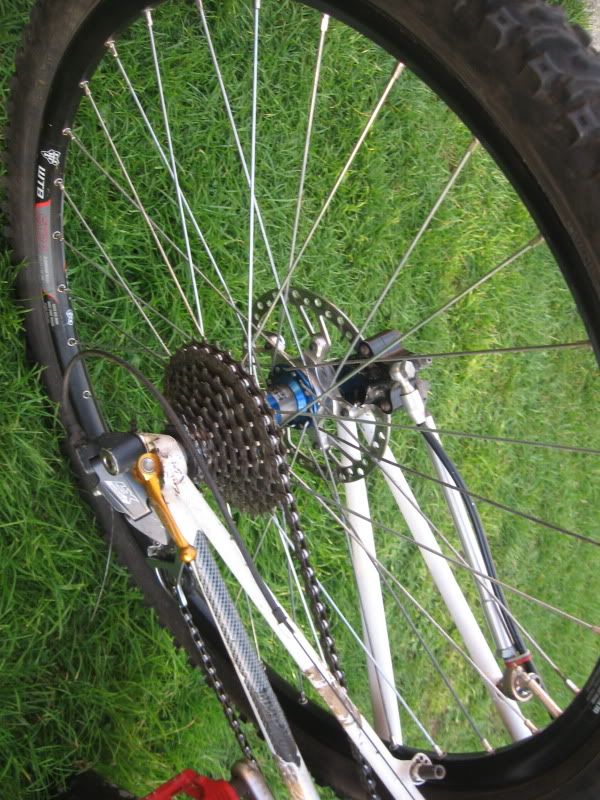

click on my mountaincycle Moho pic below to see the disc on the back of that :)

The early atx's had disc mounts on the chain stay and hope made a caliper to fit. I forget the number of the caliper.
The later ones had a convential I.S disc mount on the seat stay.
That's the frame I sold you have a picture of.

you could use a hope c2 no.2 caliper :D
i have one on my worldforce vr1
you'd need a ti-glide or bulb hub with a 130mm (roadbike) axle and a 150mm disc to make it work 8)
