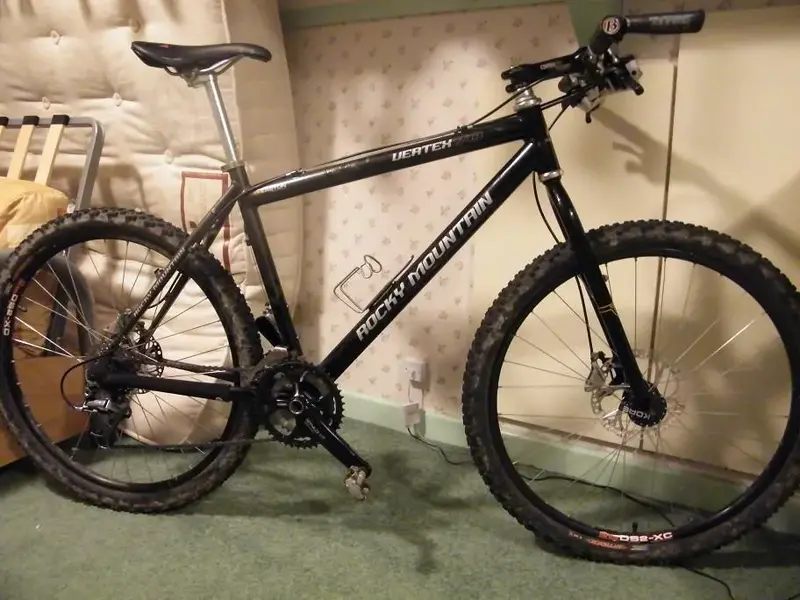

This is how the bike is looking currently, with its 26" wheel and 445mm fork.
Chainstay is still sloping slightly down towards the BB, which I think means I haven't gone too far yet :D
I'll try it with the 29" front, if it turns into a horrible handling nightmare, i'll try and lay my hands on a slightly shorter fork.
I'm wondering if a bigger diametre(rolling circumference) rear tyre and a narrower smaller diametre front might help slightly?

Andy :D how are you measuring the offset? If it was a motorbike I would use a level/straight edge to continue the angle of the headtube in a straightline down towards the front spindle. Then measure, on the horizontal, from the spindle centre to the level/straightedge which would give me the offset?
Does this sound right? :D
If its right the offset of the P2's is approx 45mm, which isn't a million miles away from ideal i think?
The bike rides nicely at the moment. If the 29" doesn't suit I may stick with how she is now and start saving for a Singular :D

Grannygrinder wrote:
Thanks for the info everybody :wink:
That looks steep as it is.
With a 29'' wheel it will be quite chopper like :?
A shorter fork would offset the difference made by the 29'' wheel.
