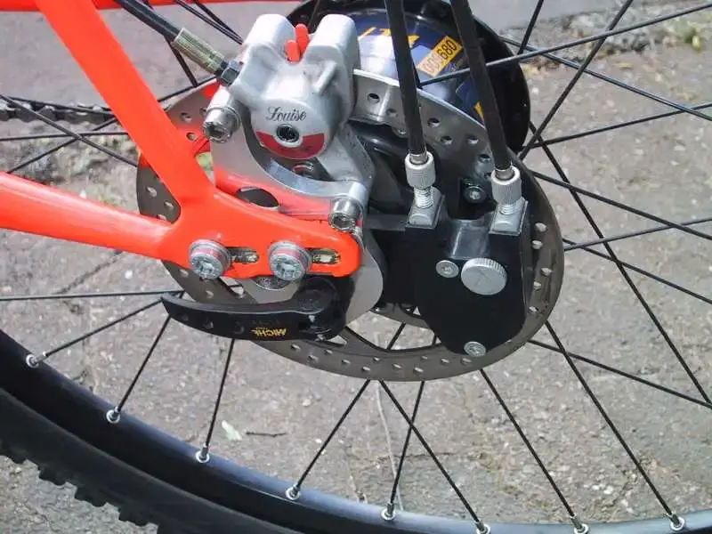

I have EBB with vertical dropouts on my cannondale 1FG and its great.
Probably best thing is you dont adjust anything in the back. You can take wheel of and back on very easilly. No worries about disk brake settings.
you can use skewers.
The downside is weight. I think is heavier than other systems.
Other system i like are dropouts u can buy from ROHLOFF
It also has vertical dropouts. which for me crucial in terms of practicality.
Same as with EBB: tensioning and taking wheel of are separate.

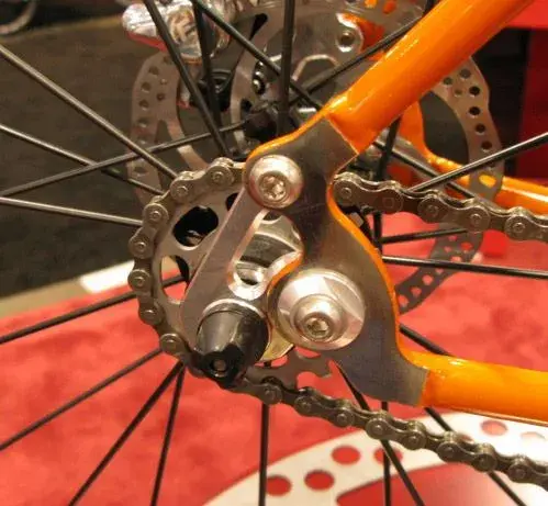

With EBB it depends on the offset. no need for halflink here.
here are other versions of that rohloff dropout (is it called paragon sliders?)
these have one bolt as a pivot and then another one or two other bolts for tightening.For tension, you rotate that dropout backwards.
