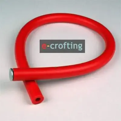

hi. i need to get a tube for brake bleeding. i've looked on ebay and the one's for sale seem to be inside dia 4.2mm. i assume these are for cars , any idea if these will fit a hope M4 caliper ?.. are all bleed nips on bikes the same size. thanks ?.. :lol:

I use a short piece of standard clear piping,not sure what size it is:?
I heat the end then push in onto the nipple,that way it stretches over :D
I got the tubing from a pet store for fish type things,pumps etc.
Yes, as far as im aware all or 99% bleed nipples are the same
Basically if it fits tightly over and doesnt fall off each time you open or shut the nipple then its good enough.

I bought a Hope bleeding kit. All I use from it is the bleed pipe....... May be worth asking if they sell them as a spare.
It needs to be clear so you can see if their are air bubbles.
Hope nipples are bigger than anyone elses. Avid need to be screw INTO the caliper. They are by no means universal.
