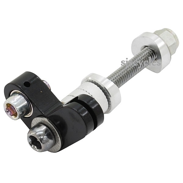

Trying to get one of these set up at the back of the GT..
Image..
Trouble I'm having is that the left canti-arm (looking from the back of the bike) hardly moves at all.. the right one pushes the rim over to the left to clamp it :?
I slackened things off a tad but then the lever pulls all the way to the bars..
A couple of folk have said these are a pita to set up so does anyone have any useful tips before I ditch the idea?

It's for the back of a '91 Karakoram with internal routing and canti-hangers brazed on.. the cable comes out in front of the seat tube and there's no guide to take it round..
I did have a sleeved cable from the exit hole straight to the straddle cable which was ok, and worked, but looked cobbled together.
So I thought, since I had a Tektro doohicky in the box, I'd run a short length of brake cable from t'exit hole into the Tektro and try that.
It looks more like a 'proper' setup but I think it needs some tweaking in the right areas..
Seems that one side probably needs to be pretty tight, tension-wise, moreso than the other.. but it's likely that I'm thinking about it all wrong and hoping that there's a logical way to get the thing working that is currently beyond me :?
