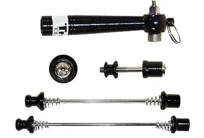

Does anyone have a Tranz-x security key for sale or I can borrow?
Mine got lost (I left my saddle bag open on a ride and found out at the bottom of the mountain!!!) and I need to take off my front wheel :?

Jam a screwdriver blade in there it should lock enough to take it of.
or as you're probably not going to be using them again, mole/vice grips on the other side will get it off.

I'll try the screwdriver and mole grips. And no, I won't be using them again. Think I'll get some Halo's which use a standard allen-key.

Just a reply to say that the grips worked to get them off :twisted:
SO, if anyone want some security skewers which have clamp marks on one end and no key, they're yours :lol:

Can you rip the axle part out and use that for something, or is the bolt head part of them?

The bolt-head is part of the axle.
