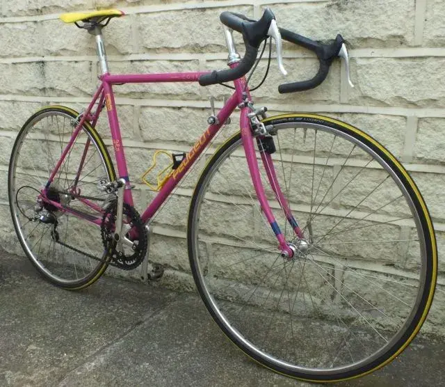

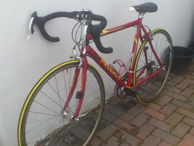

Anyway I have an extremely tight budget and would like to know what you guys think of these bikes! Yes I realise for at an absolute maximum £250 isn't going to get me anything great but I need to work with it. Given the budget I have the older models are the only ones I can get really and I have took a huge liking to peugeot bikes, as I think the aesthetics are brilliant and the rest of Internet seems to like them as bikes :P
Anyway what I would like to know is...are these bikes good (good is a subjective word but roll with it :P ) and would they be worth the cost? (With £27 on top for a courier) ( And perhaps if i should make some minor adjustments to them but i dont want to restore these bikes, but any cheap adjustments that may be worth it. :o )
I have established this is a peugeot competition 5000, correct me if I'm wrong please. http://www.ebay.co.uk/itm/Peugeot-allum ... 2a2f7f8041 I was thinking of paying max 120 (147 with courier)
And the other one with looks in better nick but I can't really tell as a novice
http://www.ebay.co.uk/itm/Peugeot-Cours ... 58a2bf8057
I was thinking max 220 (247 with courier)
Sorry for the short notice but I would like a prompt rely as they end in a couple of days :lol: even if they've expired please tell me what you think to broaden my knowledge, cheers :wink:

IMHO the top one is by far the better buy Campagnolo Ergos alone make it so :wink: Good luck and hope you can get it for your price :D

Secondly the second bike will be the better, most comfortable ride as it's a steel frame but the first bike is a better buy at todays prices

First one mate, definitely. The equipment on it is a much better standard, being an aluminium frame it won't be rusted, and having a lady owner it is far less likely to have been thrashed. The wheels also look good quality.
As already mentioned, the ergos (brakes and gear shifters combined) are worth a fair few pounds and are standard in terms of shifting, replacing the older down tube levers on the second bike!
Get some pedals and a mans saddle and away you go. Frame size will be fine, get the seat up and give you a nice position.
Finally, the second bike isn't worth 195 pounds!

That's a great bit of info on that bike cheers! I noticed the wheels looked to be in good condition, I forgot about changing the saddle so ill do that and add some pedals if I win it. About what you said about the second bike, well that's quite a relief as its right at the top end of of my (tiny) budget! think I was convinced by the price and nice paint job that it would be worth that much :p
