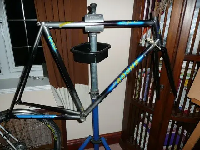

Now in UK! :lol:
Tracked this over Xmas too. Nearly bought a Bianchi EL OS, but plumped for this instead.
Will build into a beauty to match my Tommasini Tecno EL OS.

That's great news - I look forward to seeing it built up.
Go easy on that tubing with the bike stand clamp !!
That's peanuts for a new EL frame - and what a rarity you've got. Have you been able to find out any more on its history ?
A couple of things seemed interesting on that frame - I guess you'll figure them out. First was the 'Cork' lettering on the seat tube. I'm not sure if this refers to Co. Cork or is the name of the frame builder. Roche came from Dublin, so not sure it's related to the place name or not. I also wondered why the steering tube threading was so short. It looks like once headset cups are fitted, the thread does go down far enough, but it also looks like the forks are from a much larger frame with the steerer cut down. I'm sure it's not a problem. I couldn't quite tell from the photos, but there appear to be lovely 'swirls' in the gunmetal metallic paint towards the BB area, like some of the Colnago paintjobs from the early 90's.

Ive posted the details on a couple of forums as of yesterday for help. Taking great care on the bike stand (minimal pressure!).
I did as much research as I could on it before buying: there's no info on Stephen Roche Bikes before 2000 (I found archived webpages of Stephen Roches website which no longer exists) and all the posts suggest SR didnt make frames, but somebody like Carrera/ Battaglin maybe did.
SR has done some charity work in Cork, but that appears to be the only link. So is Cork a reference to the bike maker? The other clues are: the seat and down tubes are both flattened where the join the BB creating an elliptical cross-section- I assume for BB stifness-not seen this before. The dropouts are near vertical Technociclo and the chain protector says "Bio Racer"- a Belgium company that created the first bike rigs to improve the pedaling positions for riders (now focused on aero-dynamic clothing) but not sure if its original to the frame. There are cable guides under the cross bar and mounted either side of the headtube. The EL fork is sprayed to match and is considerably thinner than my Tommasini EL fork.
Weight of frame: 1815g/fork 705g
The paintwork is as you mentioned, and definitely dates it to the mid 90's. Its way better looking in the flesh than in photos (the grey is in fact a deep mauve!)
Im not sure if the fork is useable, as you rightly say the thread section isnt long enough to be present top and bottom-will need to consult with some more knowledgeable than myself as Id like to use it if poss... Still the frame alone worth the money.

Hope the forks on the SR work out OK - you may find a headset with slighly high stack height fits it OK (looks like you've gone that way on the Thommasini ?). The early 90's Campag ones were higher than the more recent lower profile types. Otherwise, some new 'EL' forks should be worth £100 to someone else.
It'll be interesting if Roche's Carrera team did get these made as a commemorative item, although it seems too recent to come from that era (as an aside, I used to have a Gios just like he rode for TonTonTapis).
I had a Bianchi (sadly stolen 10 years ago) with Chromor tubing and an ovalised downtube at the BB. So if Columbus can provide ovalised tube/lugsets at that low level, I'm sure they'll do it for something as sweet as EL.

Good news on the Roche fork: sufficient steerer to fit a threaded headset and sufficient threading. Confirmed that the BB is Italian threaded too.
