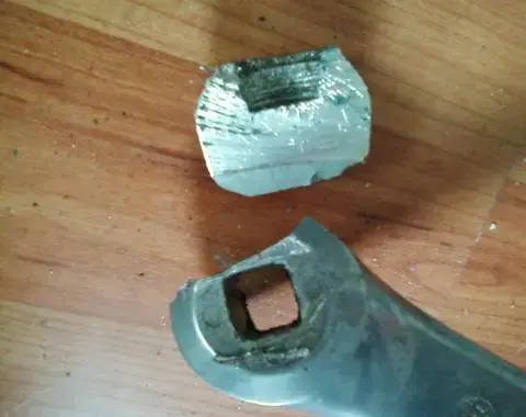

i will keep my 12 gauge under and over in the cabinet if you promise not to mess about with it!
i mean, if it is generic crank arm, shimano alloy stuff then cut it off. you can replace quickly from our wanted section. and even if it is m900 and suchlike the threads have had it, right? i know there will be a sympathetic solution that will also be long winded but, im for the hacksaw treatment :wink:
first, get a good hacksaw blade in there, tungsten carbide are good, but use whatever works. then, get chopping from the outside in as close to the bb as you can. once the metal waste hits the floor grab the arm at the pedal end and press firmly toward the bike, then back, and repeat.
the remain of the taper will stretch very quickly and it will pop off!
i've done this on 'nakedgav's' KONA and worked a treat and quickly.
the hardwork is in the cutting. after that you can get on with things. but im talking 10 mins-ish
exhibit 1 below.

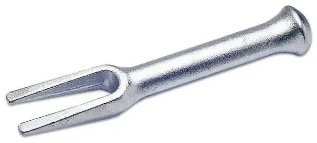

I have just the tool you can borrow, a ball joint spliter, just drive this between the crank arm and the frame it will fall off, or failing that bring it to my workshop I am sure the air saw and the air chisel will get it off :twisted: :twisted: ask Marc two tone about the air chisel lol

Thanks for the offers of help people. With more time on my hands I got home last night (didn't even take my suit off) and headed for the garage. got the ball joint splitter out and lump hammer. made sure the splitter had flat against crank and started flogging. came off easy. Marked the (scrap)frame so its not a suitable method for future but job done. Now have to see if (my dads) 2/3 legged puller will get it back off the good frame in future. My latest budget build continues..!
