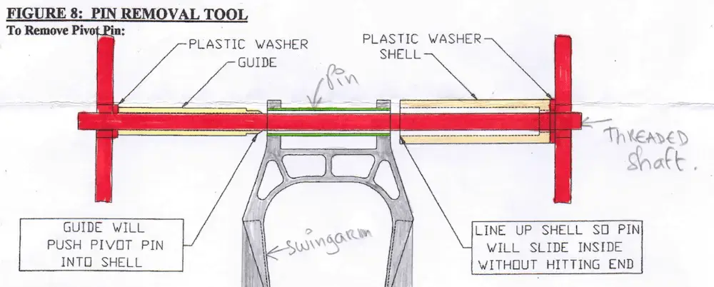

Hello,
I am looking for the tools, that all the Manitou FS representatives had, which allow the dismantling of the two rear axles of the suspended frames. Thank you for your help.
In colors the tool except Pivot Pin to remove in green color.

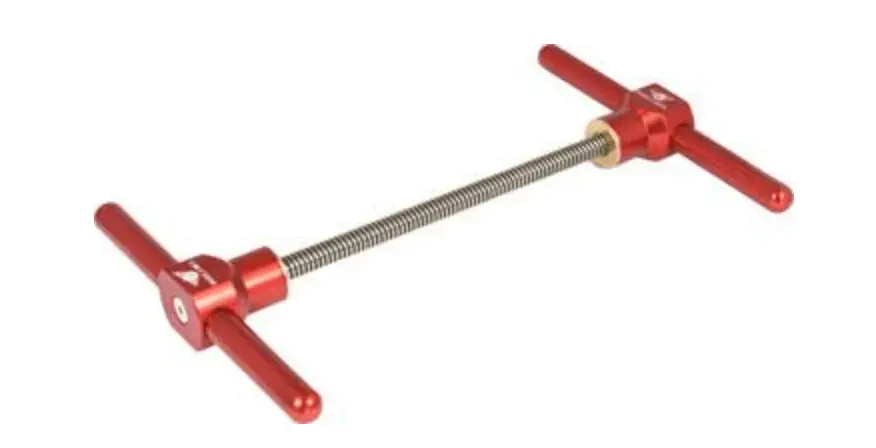

My bike repairer who worked in a company that had imported Manitous FS remembers this tool that they had received among other tools along with the frames and forks. This tool has marked him since he found it as beautiful as these bikes ... So it certainly still exists somewhere in an attic or a garage ...
or try an old marin dealer maybe they had one for the frs frames that might fit , probs easier to track down
I guess you can cobble together your own version if you're somewhat handy. A piece of long threaded rod (M8 or M10 would do fine), one can do away with the fancy handles and just use two nuts at each end with two wrenches instead, a piece of thick walled PVC pipe for the shell, the only tricky part could be the guide (might require a lathe). I will have to face this task too when I'll find time to re-do my '94 FS...

This is indeed a good tip. I will take pictures of the steps and methods used. For the moment, I still miss some parts and as soon as I get everything I'll get going.
